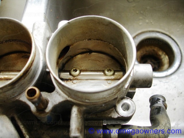

The throttle body has around 50K miles on it and as you can tell the EGR system sure got it dirty!

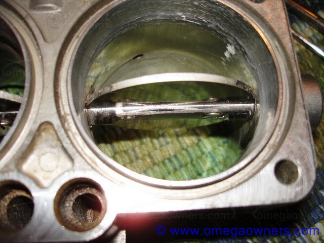

Each of the throttle plates, as you can see there is quite a bit of room to remove material from the center bar and free up some flow.
Here is the 1st stage of porting, I took 150grit sand paper, and a dremmel and sanded off the edge found inside the throttle body, I also opened up the front part so now its a smooth bore all the way to the narrowest part.
Next up, I need to clean both TB openings and move to a 600grit for a finer finish, and then finish it off with 1000grit.

All and all it was well worth the trouble.  The TB took maybe 2hrs all together to port it with 60grit paper on a dremmel, then 150, 300, 400, 800, and 1000 by hand.  entire job can be done in less then 4hrs...
