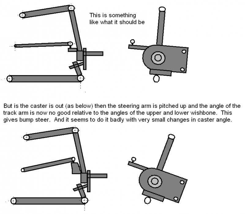

maybe if you modify the upright-and move steering bar up - I see it is mounted just above spindle height-maybe if you mounted higher-that might help

« Reply #452 on: 23 June 2013, 08:40:17 »
Yeah it does seem to be all about the steering arm height, but it seems I can do just that by altering the caster.  I did these little diagrams for the Scimitar forum so I'll put them here too.
First is just what I need to do to get round having a ball joint, the second is the effect of altering caster

ideally you want steering rod at same angle as wishbones-also is rack in line with track end-if you looked down at it? or is it further forward-if so -that wont help-and what angle castor are you running-on hotrod chassis I find 6 degrees fine-but that is beam front end-

« Reply #454 on: 23 June 2013, 21:21:30 »
Its all standard now, as Reliant intended! The Caster is 11 degree (also now as reliant intended)  I'm getting close to having as it should be now :)
