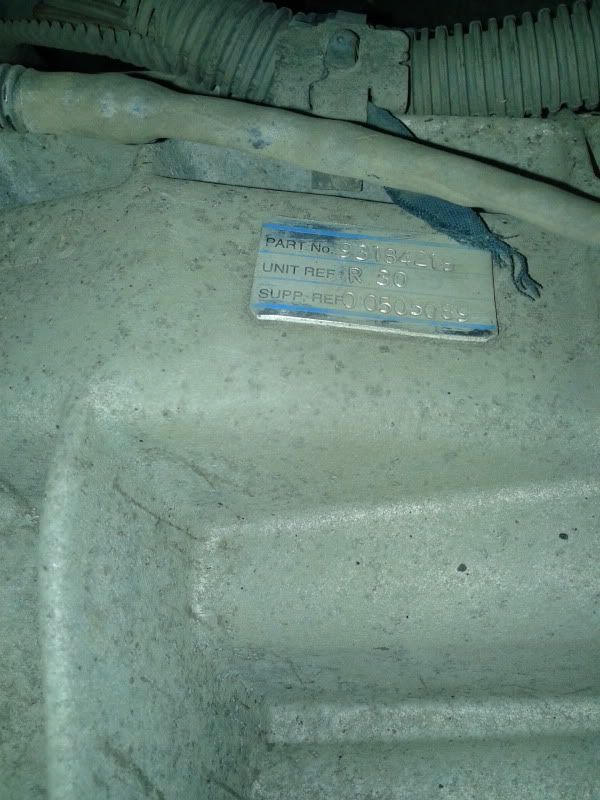

An R30 gearbox.......are you sure?

I hoe its an R30!  It seems the engine develops 290Nm so it stands to reason that Vauxhall would not fit the R28 as the torque is over that rated for the box.
I'll get under and have a look at the label soon to confirm.

The R number is on the casting :y about 3" back from the clutch bleed screw iirc...

I got under there this evening, jacked the Omega up and looked at the gearbox.  I was initially disappointed to see the R25/R28 embossed in the casting, but I think they have used the same casing and beefed up whatever the weakest link was because there is another plate with numbers and it can be clearly seen that the "unit reference" is R30   :)  :)  :)
