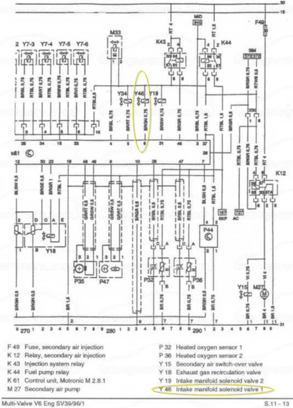

Gotcha. Will check the "negative" wire on my front multiram, and even send a new wire. Based on the drawing below my (front MR) positive plug connects with the working positive on the Rear MR plug, and it seems I need to verify/route the negative wire for the front MR plug to Pin#8 on the ECU (?). How do I know this drawing is correct for the 2.6L? anyway I need daylight for that...

Going to disconnect battery and try tracing the negative wire see which ECU pin feeds it. Since last post I found online a clearer electrical diagram so the ECU pin I am looking for is #8 and not 6. Positive front MR is definitely 12V and connected to same source as the working rear MR, so the negative wire is the only suspect.

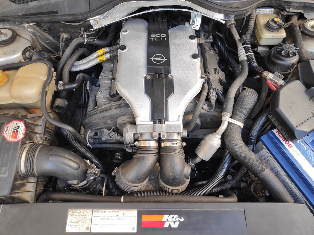

Attaching here an engine photo (front MR solenoid moved up temporarily for troubledhooting) and the ECU - could you tell if this is Omega ECU or Vectra? thanks.

What is the vacuum line to the intake above the maf? Also, I know it is lhd, but where are the vacuum lines for the multirams? They should be clipped to the cable tray as there's nowhere else for them to go...
I would politely suggest that whoever fitted that engine didn't do a particularly good job  :-\
A quick scootch does suggest that that's the Omega ECU... However the botched in IAT sensor (the 2.6/3.2 Omega uses a combined MAF/IAT) suggests that there are other things going on.
I would strip it all off and fit the donor parts from the other Omega.

Some findings and photos. The posted wire diagram is same as Hanes page 298 which is for engine X25XE/X30XE - My 2.6L Y26SE wires do not match as seen in image below.
I really need the wiring diagram for Y26SE to continue troubleshoot this. At least the questionable negative front MR wire is intact all the way to the ECU (both front/back positives connected and fine):
So either I do not know how to count, I shouldn't rely on the numbers in the ECU sockets, or I really need someone to post the correct wire diagrams.
