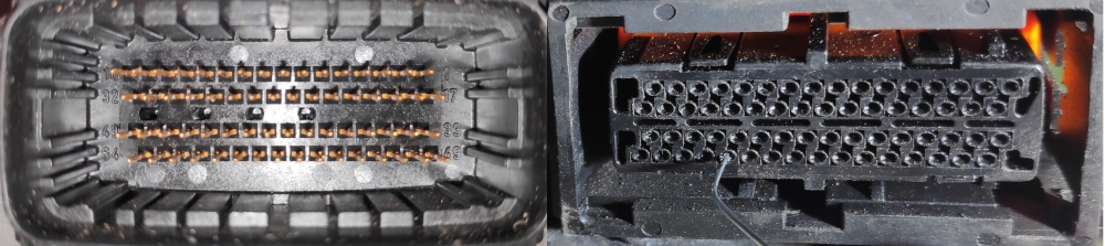

Look closer. The terminals are numbered at each end of the row.
If it's the Vectra harness, then it's not correct for the Omega ECU.
Eyal2002
Quote from: Doctor Gollum on 31 August 2021, 19:59:48
My counting was based on these raised numbers at the beginning and end of rows. I got Pins 4 and 45.
Thing is, other things will not work, specifically rear multi-ram (that does work). I need 2002 Omega wire diagram, none available in OOF or Hanes afaik.
As for the ECU, I put both versions on the current one in the car, and the one from the parts Omega. They look the same.

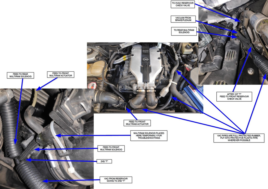

What is the vacuum line to the intake above the maf? Also, I know it is lhd, but where are the vacuum lines for the multirams? They should be clipped to the cable tray as there's nowhere else for them to go...
I would politely suggest that whoever fitted that engine didn't do a particularly good job  :-\
A quick scootch does suggest that that's the Omega ECU... However the botched in IAT sensor (the 2.6/3.2 Omega uses a combined MAF/IAT) suggests that there are other things going on.
I would strip it all off and fit the donor parts from the other Omega.
Well don't run into conclusions, set is for troubleshooting (VAC, solenoid plug etc), and when all works it will be back in place. Anyway hope this drawing will clarify things:

The pin rows are all numbered on the socket. If you zoom in your picture you can see them. Also what you are interpreting as pin #45 is in fact pin #53.
The plugs are numbered in a similar fashion where the wires enter them.
From memory, with the ECU correctly installed, the top plug is the engine loom only. The bottom plug is the Body harness.
Did you remember to "mirror" the socket image?

I did. The opposite end is pin #64 :D
Eyal2002
Quote from: Doctor Gollum on 31 August 2021, 22:20:54
When you are right you are right. My bad, low on coffee. Pin#53.

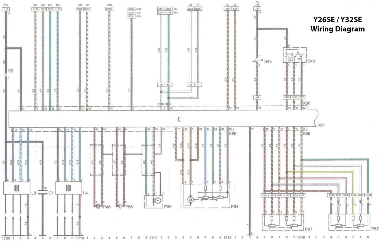

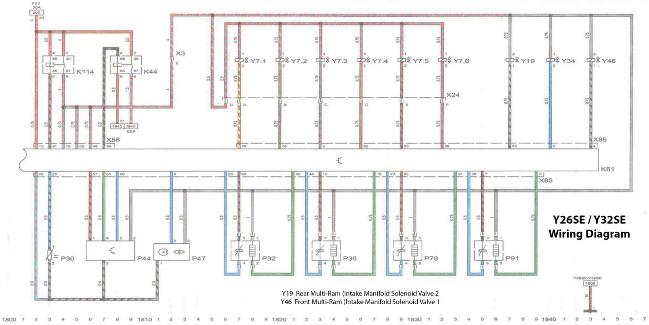

Got it!!! (sleep is overrated :o ) I got the original PDF but it's in Russian, PM me if you want it.
And it confirms pins 4 and 53. So back to square one, why the ECU will not command the front multi-ram to open.
Anyways here are the drawings for OOF reference:
