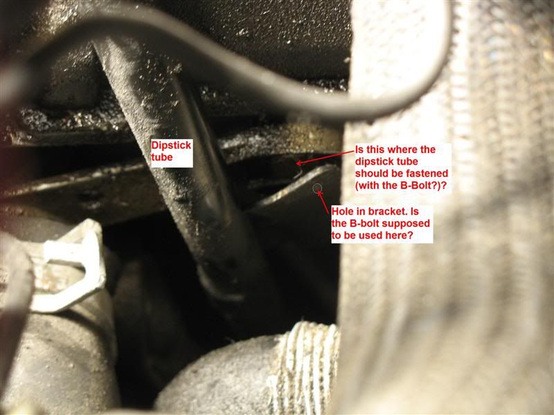

I took a quick look under the bonnet this morning and with good help from a 500W halogen lamp, I was actually able to see what was hiding down there  :y
There is a bracket attached to the dipstick guide tube. However, it is not fastened to anything else, that's why it can be freely rotated.
If you look at the bracket, there is some kind of "bar/metal plate/bracket" behind it (on the engine) with a hole that might be where the dip stick bracket should be secured with a bolt/screw.
The hole in the dipstick bracket and the hole in the part behind it are not aligned. The dipstick bracket hole is higher placed than the hole behind. It's difficult to see exactly how much but it's probably about 10-15 mm which equals the false indication.
This is most likely what's causing the problem.
See attached photos for details:
http://ladda-upp.se/bilder/zawowglpndtr/
http://ladda-upp.se/bilder/osmrybwscrvrbf/
http://ladda-upp.se/bilder/zibpapguuojpvw/
http://ladda-upp.se/bilder/ncuewsxmzgsdy/

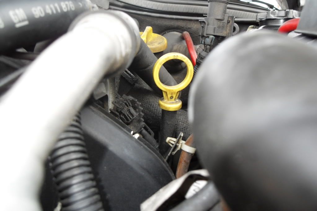

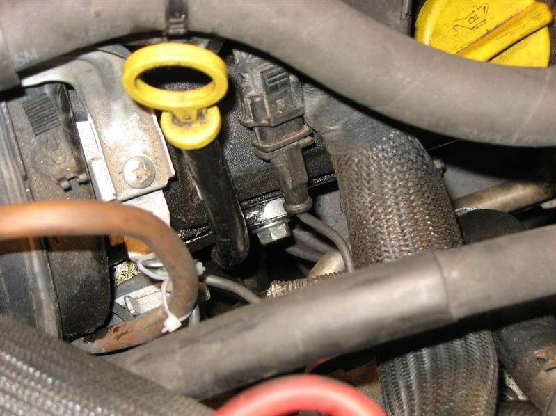

if i have done these right it might give you an idea of how high/low the dipstick should be  :y
« Last Edit: 21 November 2011, 14:03:21 by fiend61 »

Thanks for posting the photos, it's always easier when you have something to compare with.
I decided to use some "gentle force" in order to find out if the dipstick tube really was seated properly and I found out that it wasn't! With a little help from a hammer and a piece of wood as protection, I managed to get the tube down and now the oil level on the dipstick is far beyond max.!  ;D

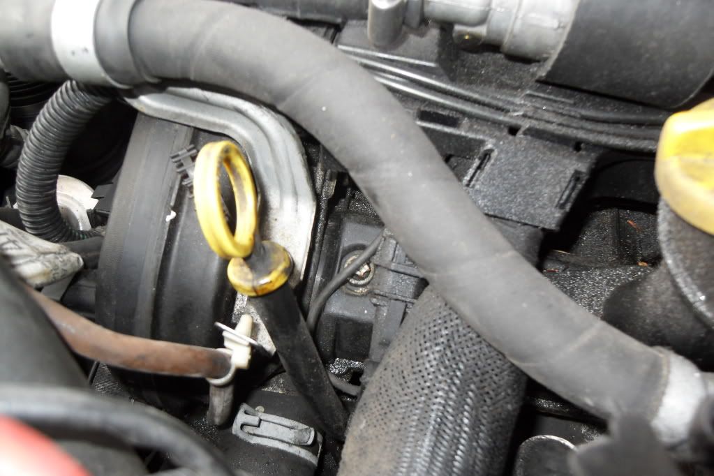

Below two links showing how it looks like now. The secound picture shows in detail how the dipstick bracket now is aligned with the hole behind. Is this where the b*astard bolt should be used??  ???
http://ladda-upp.se/bilder/lvfqzgzkbynbsi/
http://ladda-upp.se/bilder/rdjkxwfhlkqfck/

« Reply #23 on: 24 November 2011, 14:12:58 »
First step would be to find the location of the B-Bolt, or at least the hole where it is supposed to be fitted.
This was easier said than done... ???
Exactly where is the hole that this annoying little bolt is supposed to be screwed into??
I checked the thermostat guide, but the engine in the guide does not look the same as my 2.5L  :-\
I cannot see any lifting eye, guess it's gone or maybe I'm looking at the wrong place??
Is this part supposed to be fitted between the dipstick tube bracket and the "hole in the engine" (which I can't locate...)?
Coolant transfer pipe...ehhh, where?  :-[

This may be of some help. :y
Re: Oil level Omega B 2.5
« Reply #25 on: 24 November 2011, 15:32:46 »
Looks like your arrows are pointing at the correct things,although it appears that the dipstick bracket is sandwiched between the bracket on the pipe and the lifting bracket,rather than in front of the pipe bracket. :y

Thanks, that pic finally made me understand how the parts should be mounted   :D
I also realized that there actually was a B-Bolt fitted (holding the coolant transfer pipe), I just couldnīt see it!
As said before, the lifting bracket is missing but I'll just have to fit one when I plan to take the motor out of the car  ;)
It took a while to unscrew the B-Bolt, it is really tight down there, but as soon the bolt was out, it was no problem to refit it, this time keeping the dipstick tube in place as well.

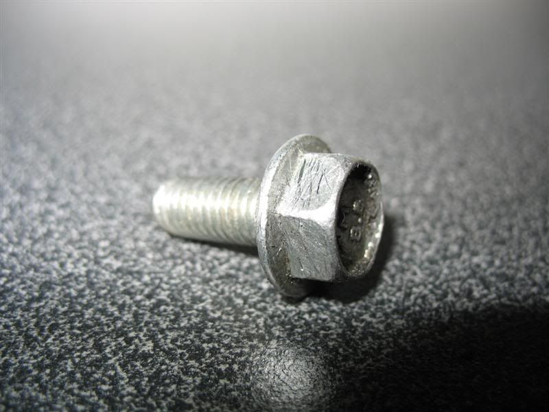

Thats not the original B-Bolt, which left the engine factory with a torx bolt :) - not that it matters :y
