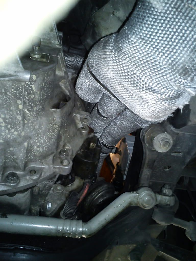

Yes found in your history. Headers hit the steering and no good for auto. That's not good is it?  :o

I have no trouble driving arround with it, and i got a manual, so i don't care  :P
This is where the steering hit the headers on a hard left turn
http://i259.photobucket.com/albums/hh301/Andygun89/DSC00163.jpg
« Last Edit: 27 December 2011, 11:23:01 by Andy89 »

« Reply #11 on: 27 December 2011, 11:23:31 »
Would it take much to alter them?
What do you mean?
What do you mean?
Alter them to miss the steering and the auto box...?
