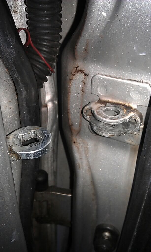

I tried to do the simple job of changing the door bushed and I think I may have damaged the straps inside the door. I put the bush and did the nut and closed there were a couple of 'pops'. I took the bush out and it was broken to bits and now the strap is inside the door and wont come out. Come on people, tell me the worst  :-[

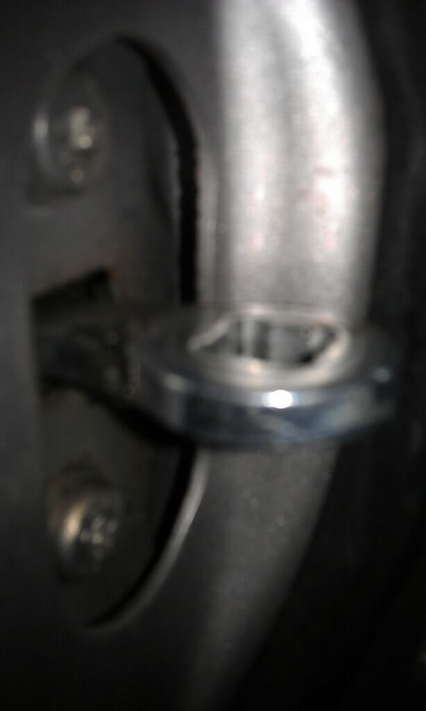

Not really a lot you can see from these pics. Cant pull the damn thing out.

It doesn't look like you have ripped the check strap out of the door mate, because you can still see the bolts and metal intact in the 2nd picture.
As said, the strap has just gone to the closed position and needs pulling out.  Block of wood under the strap to protect the door and provide leverage, big ol' screwdriver through the strap and lever it out.  It will resist, but it will come.  :y
