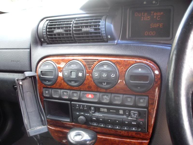

Is it the one with the climate control like this?
If so you need to reach up behind through the stereo aperture and feel for a flat aluminium bar about 6-7 inches long. This needs to be pulled downwards. It's quite hard to get it moving - I used a screwdriver to *carefully* lever it downwards at one end them worked across to the other end.
Once the bar is moved down the facia virtually falls out.
