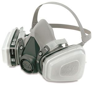

after some problems with my lungs (lesson learned) I started using this
its 3m paint mask which is widely used and very effective.. so I recommend it..  :y
