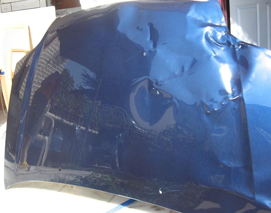

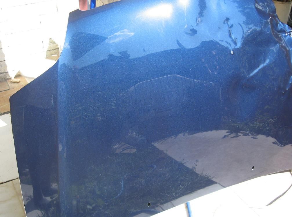

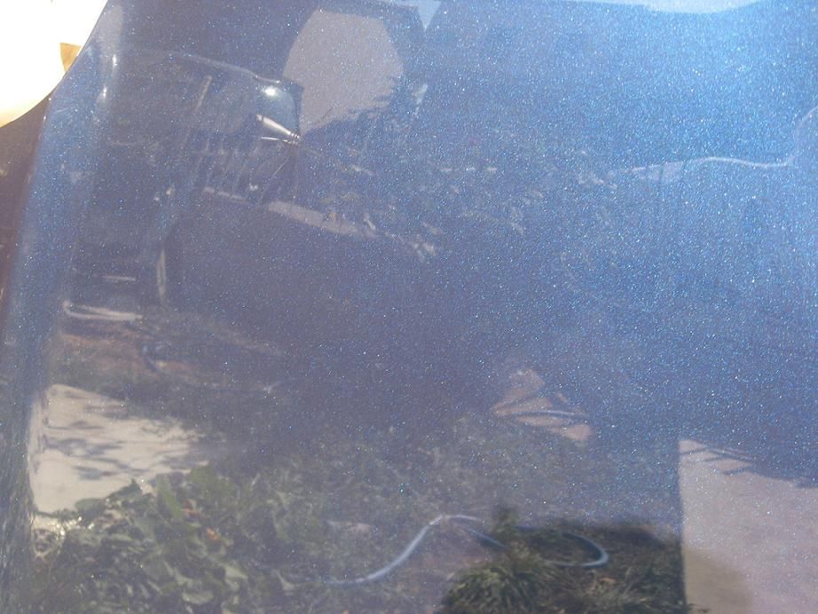

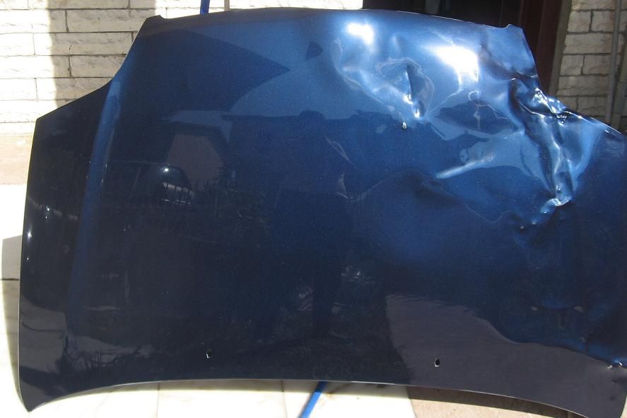

here are the pictures of trials/ tests
brief of whats done
sanding with 1500 grid without dual action (no rotary) - bosch gex 150
then polishing with G3 (rotary only) - hitachi
then polishing with  american eagle (no rotary) -bosch gex 150
final protector not applied
very close picture under sun
and some others
