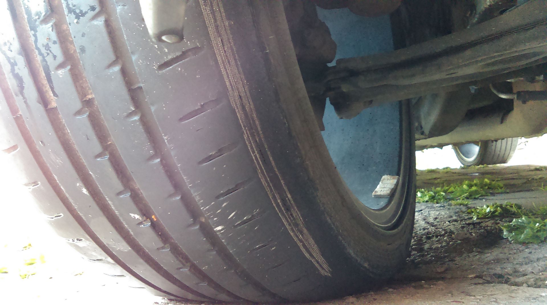

Only noticed the other day I had some pretty bad inner wear on my OSF tyre. Odd really as I couldn't feel anything except a tiny steering wheel wobble at high speed.
New tyre now fitted and tracking done but a very good tyre ruined.

Identify the broken bit, replace and get it set up properly otherwise the new tyre will do exactly the same thing ::)

The new one will go very much the same way unless you replace the defective suspension bush that's causing the issue. Tracking will do sod all  :y

Yep, and it will likely ruin another one due to excess CAMBER. ....NOT tracking. Excess cam per can be due to a failed bush or bad adjustment after suspension work
At very least get camber checked o full get set up rig, such as hunter hawk eye. Fleet fit  Loughborough nearer than wheelsinmotion.co.uk for you are they?

A thousand miles is enough to completely destroy a tyre with a poor set up...

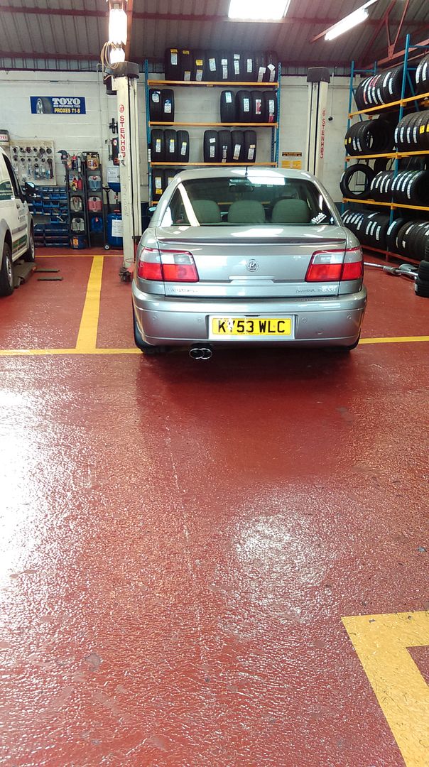

Looking at how that weight has been positioned, I wouldn't trust the fitter to do up their own shoe laces.  >:(

Nice tailpipe  :y
Slightly off topic, but is exhaust full stainless ?
