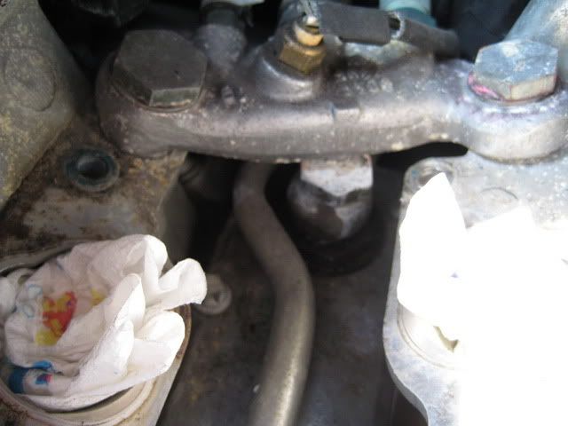

Just nipped out to do her thermostat and cam cover gaskets...
and Ive been met by this in the V.
not sure if Ive an oil cooler leak, plus somethings going on with the coolant bridge.
What do I need to order to sort the bridge out?
Im about to check the wetness for oil, to see if I need to do the oil cooler as well.

Looks to be just coolant thats run through oil.
thats one bit less...
Just the bridge to sort
explains where the tiny coolant loss was anyway.
Anyone know what I need?
cheers

4 x dowty type seals - plus 2 new through bolts as old ones can break!!  HTH mate

cheers, washers in stock, bolts on order
so ill remove em and see if I need the bolts.

bolts are fine :)
I must be lucky, i've never had a banjo bolt snap yet ;)

Well thats the thermostat done....
And a big sense of achievement for me  :D
Camcovers in the morning  :y

Nor have I but have read on here that it can happen - still got a couple of newuns  ;)

Im not that bad any more, can tackle a lot myself.
B-Bolt - my 1st ever, awkward, but not too bad in or out, flexi ended ratchet spanner did the job nicely.
Didnt even need to sort the thermostat bolts, my pattern thermostat was genuine old style GM, with the GM logo ground off  ;D

Had it all finished and back together by 10:30 this morning, been out and about in it and all seems fine  :y
