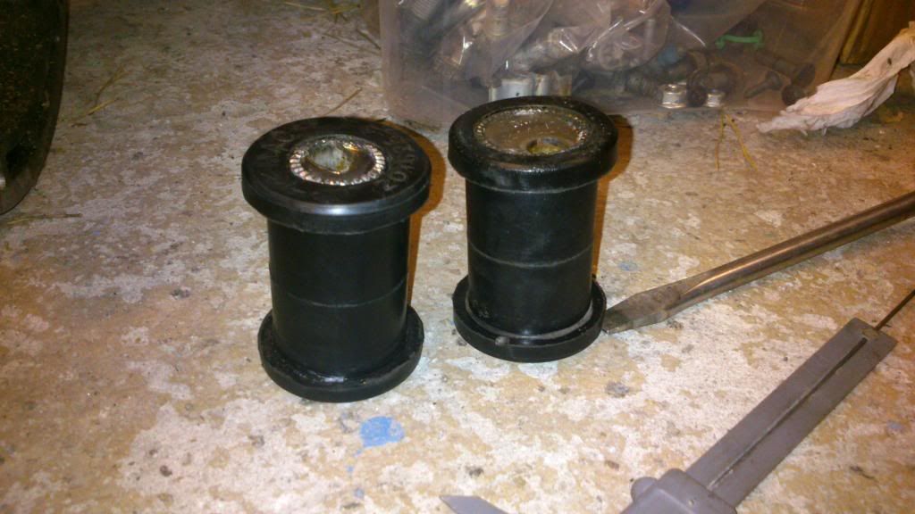

Andy89
  • Norway
  • Posts: 248
    • 97 3.0 MV6
Re: Rear Camber
« Reply #12 on: 22 February 2013, 20:55:24 »
Camber-correction bushes in either poly or rubber are a good solution when used in the outer location. They aren't suitable for the inner location because of the camber-correction system as Chris correctly pointed out.
Now i'm no suspension expert, but i'm guessing there's a reason they made them with much more rubber on the inner one?

Re: Rear Camber
« Reply #13 on: 22 February 2013, 21:20:09 »
Yes sorry.
Bind= seize/stick/get stuck. When compressed the suspension may stop working. Either refuse to compress any more or stay compressed and refuse to rebound.
Rear tie rod is also know as a camber correction bar. It needs the rubber bush to be soft and deform as the suspension compresses and the tie rod pulls on the rear trailing arm, to correct the camber/toe.
Rear tie rod was an addition to the omega A/Carlton rear subframe for the omega B  that we know now.
