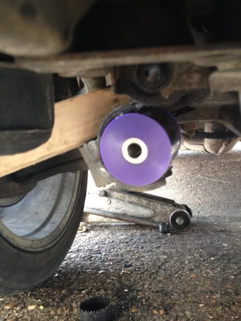

Could somebody help me please....
I getting to point of insanity, I have changed wishbones twice now put polybushes in the front bush of the wishbone.
Had 4 wheel alignment (spelling)
And today i find this:
O/S
N/S
Now the problem i have been having is when braking it was pulling to the left since fitting polys it is i'd say 95% better on braking, What could be causeing this with the nearside wheel a little bit further back than the offside.
Thanks in advance.

Yep, your castor angle is out, where did you have the alignment done?

As said subframe position needs correcting. Might also be caused by accident damage.
However, I've seen worse on my own cars with no pulling on the brakes.
So it's important to correct that issue first obviously.
Question no. 1. How tight are the wishbone bolts? I'm looking for a torque wrench setting figure. :)

If i remember i did torque bolts upto 210nm.
Re: Front wheels
« Reply #12 on: 14 March 2012, 15:00:36 »
120nm plus angle tighten 30 degrees then a further 15 degrees
Dr_X
Re: Front wheels
« Reply #13 on: 14 March 2012, 15:07:21 »
Plus you must do them up with the full weight of the car on them....
Re: Front wheels
« Reply #14 on: 14 March 2012, 15:10:45 »
Not with polly. Doesnt matter.
Oe bushes yes, wheels must be loaded with suspension arm sitting at correct ride hight.
