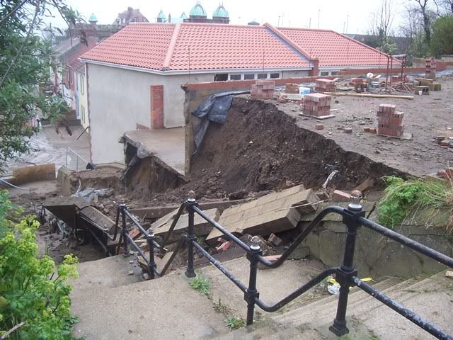

Had an eventful evening last night following the rain and thunder when we had a landslide of mud run into our street when the "supporting" wall behind a recent new build collapsed. As you can see it fell onto the steps and narrowly missed a young lad. All the locals are not surprised tbh as before the house was built weve had mudslides before in heavy rain and unlike a local guy who built his own house into the cliff but spent about £100k on piledriving and shoring up before he even started to build his property this lot just quickly threw the place up with seemingly scant regard to any thought of properly shoring up around it. Anyhow, spent last night helping the builders clear up and make safe though the guy in charge seemed more concerned about what all the locals were saying to the press ;DIn fact today he has been doing his best to intimidate both locals from making comments to the press/TV and the journalists themselves so obviously this hasnt endeared him much. Guilty conscience perhaps? Luckily no one was hurt but the houses have been sold with one buyer due to move in in a couple of days. Im no builder or engineer but from the photos I think its pretty obvious that the land behind the property wasnt shored up correctly nor adequate drainage provided. Another case of trying to make a quick buck on the cheap?

sounds like if thay where pile driving for the house that the soil was no good.the supporting wall would of been designed by an engieer with dranage beehind it,so the biulder our engieer  has mest up.blame game now.i have done a few now with what looks like egg cartoon stuff to back off wall to allow water to run down into a land drain normally 4"pipe with holes in it going to a drain and souronded by pee single.

yes sandey soil no good.but that wall is no good how did thay think that wall was going to stand up, the plastic sheet up aganst the wall is no good any water will run to bottom and wash it out,the wall itself is no good not thick enough no upright supports,made from blocks have no sheer strengh.even if thay had used this system in pic below it would have still colapsed,weve done ones smaller and the walls where three times that thick.

the membrane has a drain at bottom and is not air tight,the capping on top allows air in and out top of pic is the rain water pipe connected to the drain so it does not wash out soil below.

retaining walls unless part of the building are not covered under the Building Regs.

Problem is that if a retaining wall is detached from the structure of the house or does not provide support to the house its not covered by builidng regulations
