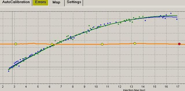

Just been out for a calibration/map
Pressure 1.3 bar, here is the map:
I did finally get the lines to overlay completely.
Still get an awful jolt after a gearchange at high RPM...
Currently configured to use petrol after 4k rpm, which is working fine and eliminates this, but, I'd like it to run all the way on gas :y
That map looks very flat. Not sure what's going on there... I'm sure mine is a bit more peaky than that, but I haven't actually looked at it for about 2 1/2 years. ;D

The Stag mapping is always a compromise, as different driving styles knock it off
  • Posts: 36505
Re: Questions for Stag 3.2 LPG owners please
« Reply #39 on: 18 April 2012, 19:55:45 »
That's because it's only a 2d map.. On those early ECUs at any rate.
