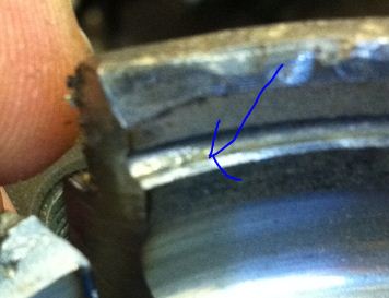

Is this piece deep enough to show this none existent baring shell ?

chrisgixer, hard to tell from pics, but where blue arrow is, is that a 'join'

Surely then the bearing shell between the 2 cuts should simply fall off :-\ only gravity holding it in place :-\
Unless it's part of the casting...
the cut on the right isn't deep enough, I'm not even sure the cut on the left is quite deep enough either  :-\ :-\
Exactly as Al says. If that is join marked by TB, why hasn't the shell/race fallen away from the part removed?
Unless its part of the casting/hub?
