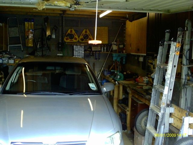

Kevin Wood - I thought from the pictures that your garage looked unusually tidy ;D
S'pose I should get off my fat lazy backside and sell most of the Omega bits cluttering my garage. I think I need 250 posts to sell on here though

some awesome workshops here girls..... feeling a bit embarrassed about my undersized shop  :-[
never mind, a good de-clutter (without pops knowing) will soon free up some work space  :y

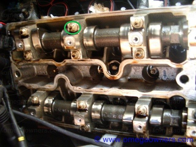

Are these the head bolts??

Re: Head Gasket Talk including ''What's your workshop like''?
« Reply #42 on: 18 May 2012, 20:23:14 »
cam bolts head bolts are lower down in the head :y

Cheers Martin... is it the red arrow where what looks like a bolt is lurking?

martin42
« Reply #44 on: 18 May 2012, 20:34:28 »
will be about 10 of them
