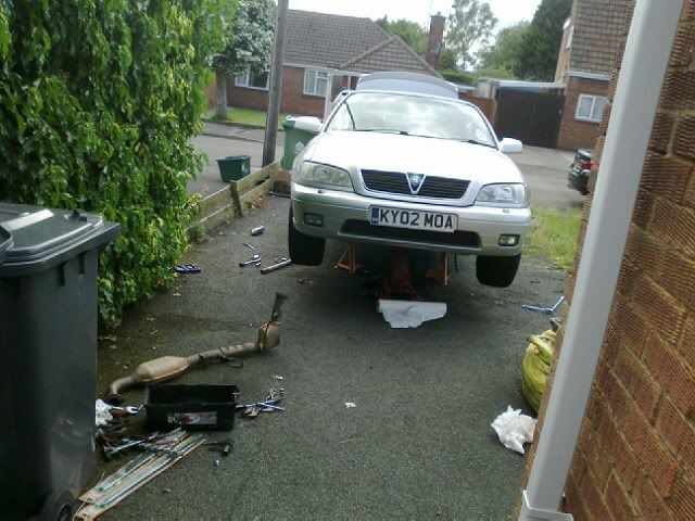

So - Car raised up on axle stands. (Please note the 3 tonne jack has not been used to lift on the crossmember. It's simply resting there as a 'get out of jail free card'. Take no chances under these things).

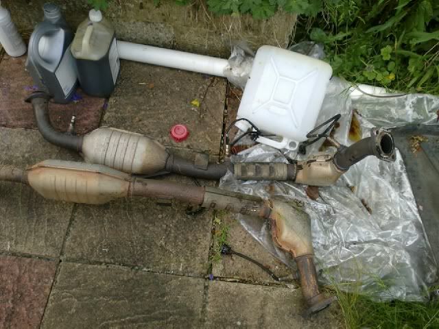

Next job was to remove both Cats. I'm not going to lie, the downpipe nuts were a barsteward, and the good old Irwin grippers had to come out along with Mr Breaker Bar. The mid section joints fancied a fight too. Ran out of plusgas, and no wheels to get to hellfrauds, so had to make do with WD40. Was better than nothing.
But here they are. The Offside one is a little worse for wear, and won't be re fitted, as I can source a much better one.

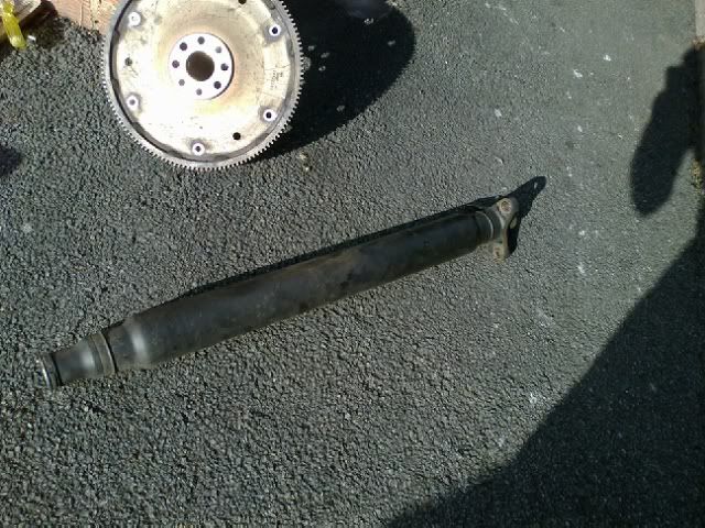

Then off with the propshaft: (Ignore the drive plate in the background, pics taken retrospectively! More on that later).

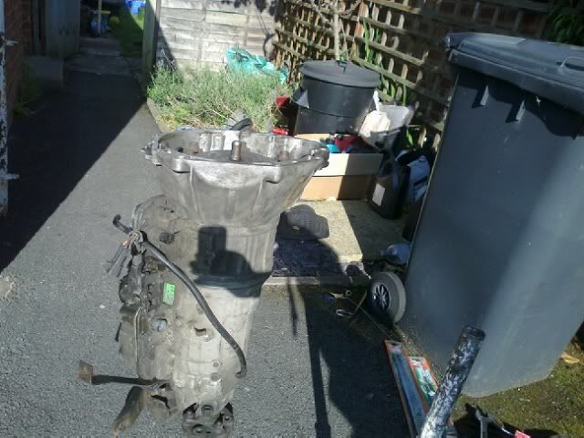

Now, put bluntly, with all the crap out of the way, it's time to lower the box off off it's supporting rear mount, and drop the box and TC together on the ground. I have to hold up my hands, I wasn't toooo gentle with lowering this one, knowing it's going straight in the skip....  here it is removed from the car:

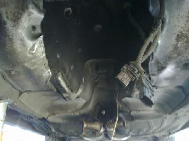

With the prop and autobox out of the way, now a nice bit of room up under here! I will have to get under here to pop the rivets out for the auto gearstick assembly.

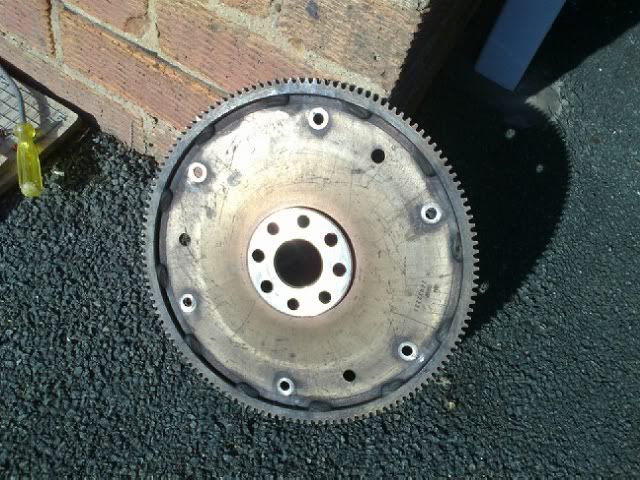

Here is the flex plate removed from the engine. Given the noise I wondered if I'd find this broken, but it was all intact and hunky dory...

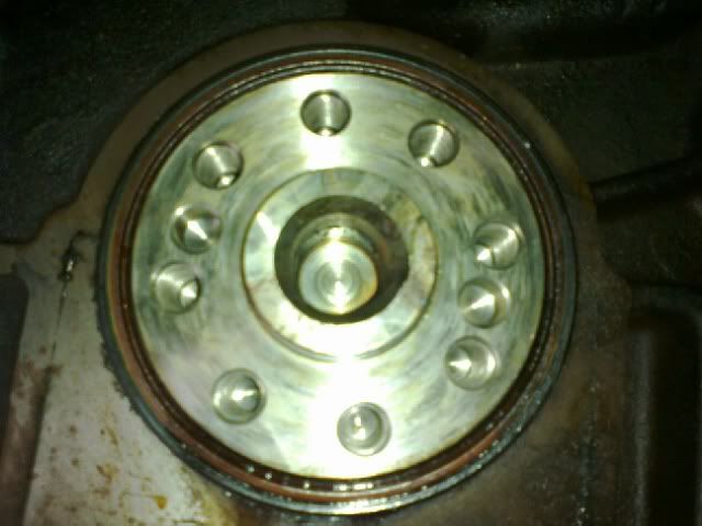

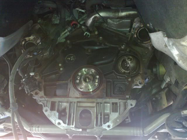

And here you can see what it's left behind - the rear crank part of the engine. This is a great opportunity to have a nose around the back of the engine and look for leaks:
It's sadly not hugely clear in the picture below, but there is evidence my rear crank seal has been leaking. This will be sorted before it goes back together. (They're not cheap, but you'd be daft not to use it, or use anything other than a genuine seal, given the location and effort involved to get to it)

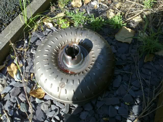

Torque Converter. Looks ok, no bits came out of it, but I don't know of an easy way to test or be sure:

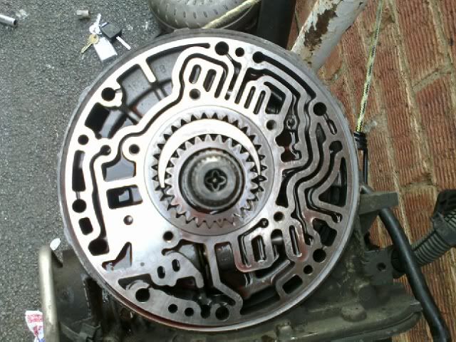

Front thrust washer. Expected to find this in bits, but was fine:

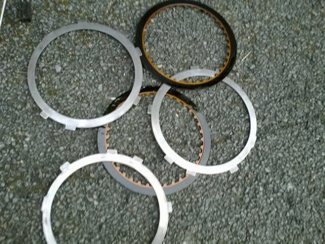

Collection of clutches.... nothing here that would cause the awful noise..

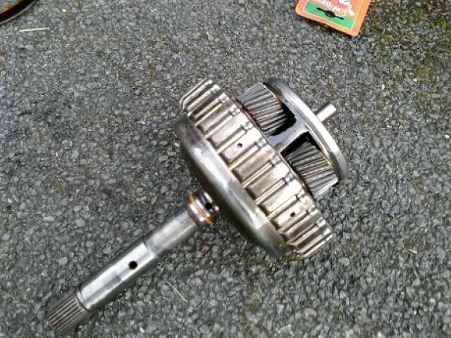

Spragg clutch assembly. This didn't feel too great to turn, but hadn't fallen apart like the one on my previous autobox!
£34.01 ...... There's a brand new one in my glove box waiting to be fitted to mine!  :y :y
