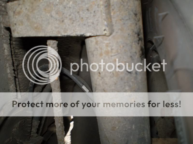

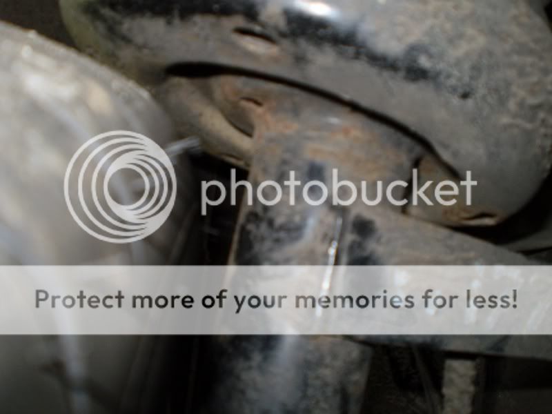

« Reply #24 on: 15 July 2012, 15:42:05 »
A couple of piccies of the shock and tyre relationship
Looks okay I think  :y
yep.. cant see any sign of interference.. :y
 however,  any spacer can finish this "close relation" forever :)
