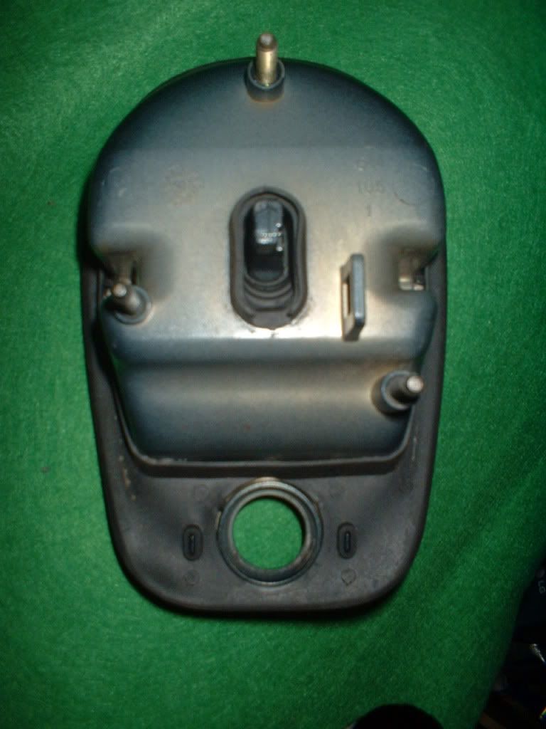

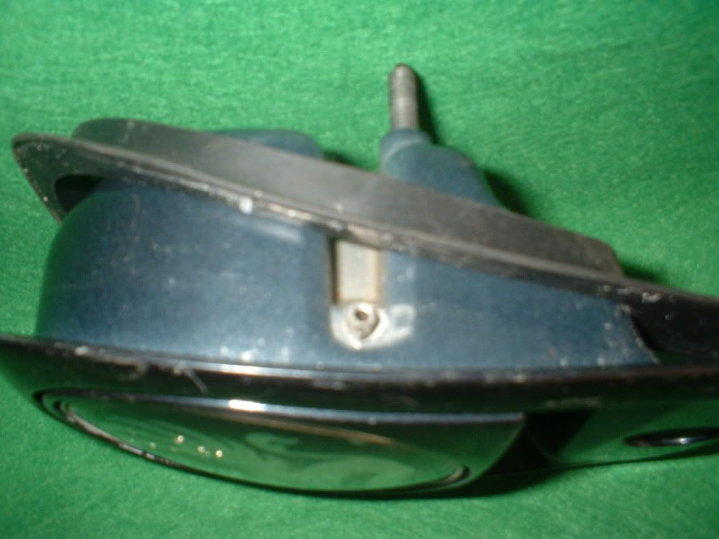

RIGHT! I see now, the pivot seems to have snapped, see this pic:-
Looks like you either drift the pin out & replace, or get a complete handle assembly from a breaker, and swap the lot.

Swapping the handle is easy, and so is the change-over of the lock. The handle assembly is on show once you remove the boot trim, you will see 3 nuts, like this:-

Sorry but it looks like your pivot pin has snapped. The "D" shaped bit that lifts to unlock the boot, is only fixed on on one side, the surround is held in situ by the three studs, yours looks secure, but the steel pin will have sheared. It's a long time since I replaced my handle, but I do remember it was a doddle. I "upgraded" mine while I was at it, from a flat badge, to the more modern PFL chrome raised one.

I hope you understand the above, it's just the middle bit that you lift that has a sheared pin. I would take it off , have a look, and either replace the pin, or swap the complete handle assembly. (remember to keep your old lock)
