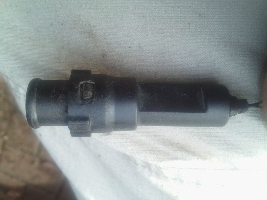

right got the wheel off the non-runner to practise removing the pad wear sensor as i want to fit new ones when i do my service next week.

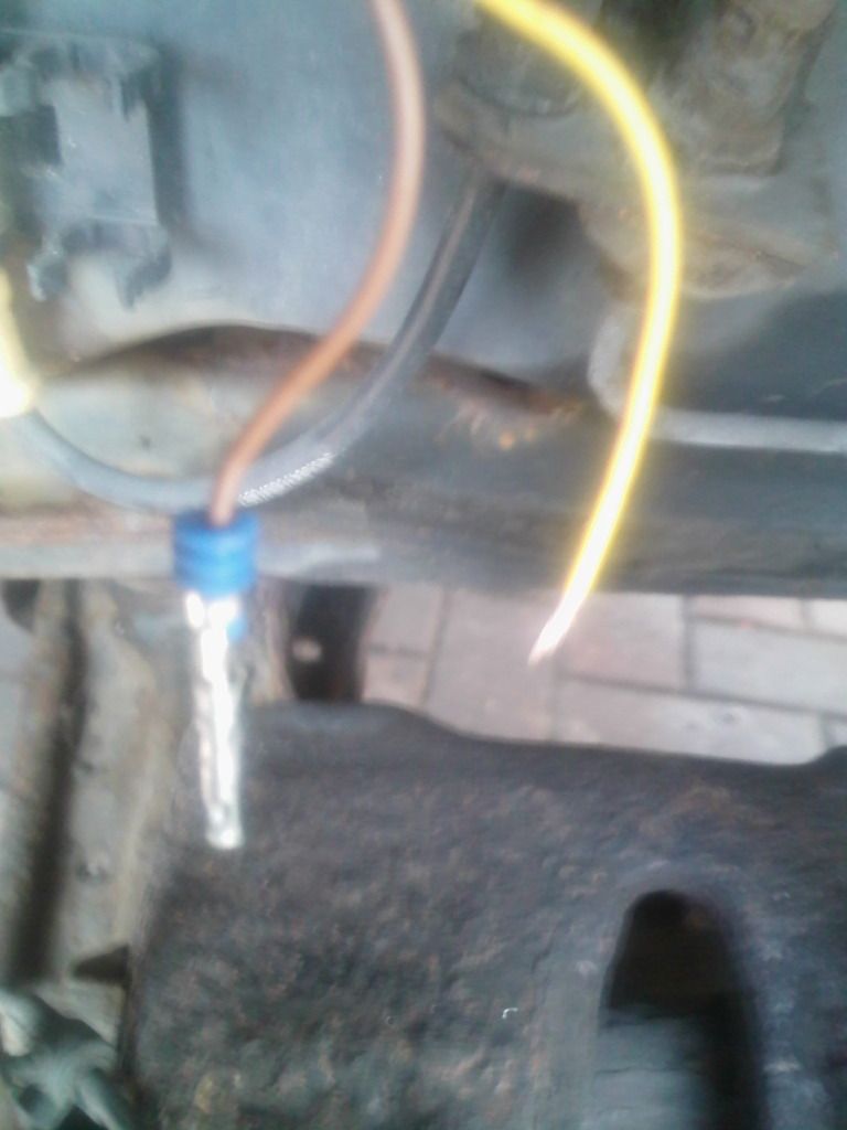

now i looked at the cinnector and i knew i was going to have problems  ::) so as the non runner is being scrapped very shortly (as soon as i get a soclet adapter for the head bolts) i simply pulled out the two wires to get the black connector out... these are the wires that were left over (as said dont worry this is on the non runner thats being scrapped  ;)
now i know for a fact youre going to tell me that i cant do it this way on the good car  ::) (i know this cos my life is an excercise in murphys law  ::))
soooooo assuming that the black thing in the following pic is the thing that comes apart can someone explain how you do it cos i tried and couldnt!  ::)

Squeeze together the two raised shoulders either side of the retaining tabs or careful use of a small screwdriver to release the tabs

I had a problem with mine....i squirted electrical spray on the connector...left them for ten mins and then used a small electrical screwdriver to prise the shoulder on the plug passed the holder and it came apart ok....maybe not the correct way to do it.but it worked for me. :y
Agreed.  :y Once opened out a bit, wiggle and pull apart.  :y
If sensor is salvageable, you can be tight and tap the pin out with a small Allen key. Just the mere sight of a screwdriver to the ceramic part snaps it.  ::)  ;D
This obviously doesn't apply in your case.  ;D ;D

Webby - its like a light bulb - twist and pull :y

 ??? ??? ??? No it's not ....... it's as Rob G says - squeeze together at the shoulders to release the locating tabs & then pull apart. ;)

ok, so ill give it another bash tomorrow. Dbug when you say twist and pull by the sounds of it (and going on what the other guys have said) you sandwiched the ''tabs'' out of their ''window'' to the side and therefore they couldnt snag on anything when you pulled up.  :y
i tried to use my fuel filter pliers but that didnt work.
god, why does everything have to be so bleeding difficult, especially when its ''just'' a conector. i hate these connectors with a passion. same as the fuel filter ones..... quick release my BLEEP! lol
