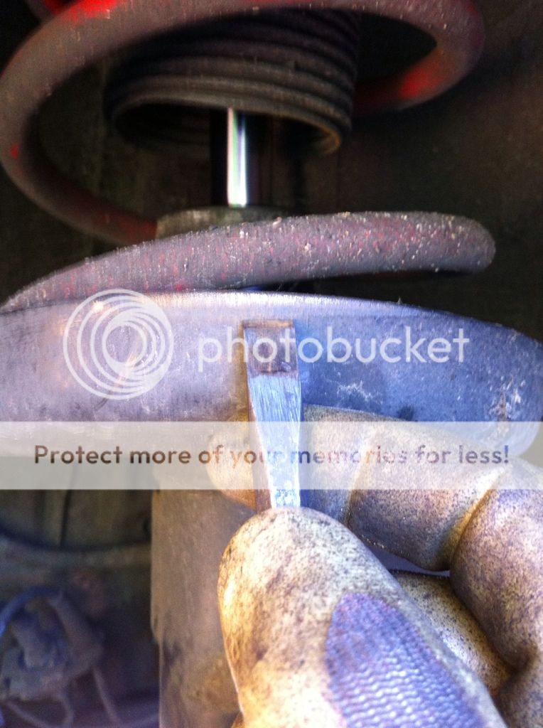

This a Bilstein b4 front shock "spring cup" as I call it. The rub line above the chisel shows where its been rubbing on the outboard vertical face of the wheel arch liner. Think I found the hollow clonk as the suspension compresses.  :(  :)

Oh, and its the same both side btw.
Re: possible problem with Bilstein b4
« Reply #2 on: 14 February 2013, 10:26:07 »
Weak springs/soft shocks/too little camber :-\
Unlikely to be the third one, but how many miles have the struts/springs done?
« Reply #3 on: 14 February 2013, 12:05:12 »
They where both new, about 18months ago. Set up is as wim.
I need to measure the distance from the outboard edge of the spring cup to the shock shaft and compare with oe.
I suspect the Billy's spring cup is too wide. :-\
« Reply #4 on: 14 February 2013, 12:21:38 »
That would suggest that they're not exactly compatible with the Irmy/OE springs :-\
« Reply #5 on: 14 February 2013, 12:31:02 »
Mmmmno, don't think its that, the rim doesn't support the spring, there's a moulded rubber pad shaped to the sping base that supports the springs position.
I think the rim is there if the spring brakes so it can't skew sideways. :-\
« Reply #6 on: 14 February 2013, 12:44:05 »
Other possible though is that the top mount has collapsed or is faulty.
I'd be surprised though.
« Reply #7 on: 14 February 2013, 17:16:20 »
IME, that would show through the steering and general handling. Any play in the leg when it's up in the air :-\

the suspension only needs to compress an inch for the spring cup to meet the wheel arch liner
« Reply #13 on: 14 February 2013, 20:09:31 »
That's not alot :-\
« Reply #14 on: 14 February 2013, 20:42:27 »
That's not alot :-\
i'll have a look at some point
