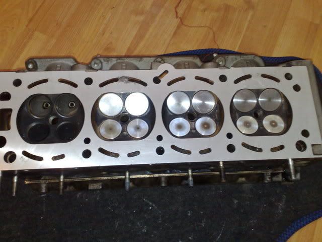

And here is how it looks after a skim. Note the edges of the valves - the machine shop have taken it down very close, but should be good for LPG / High octane fuel.
Looking good for the skim, but still needs some more work. It's filthy still inside, and there are bits of swarf around.
So I'm taking out the valves, cleaning it all out, and replacing the stem seals.
Didn't have much else to do tonight, so out comes the Valve spring compressor ;D

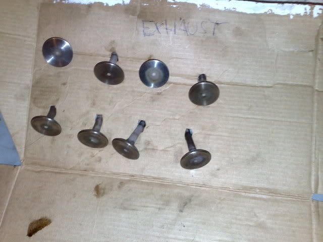

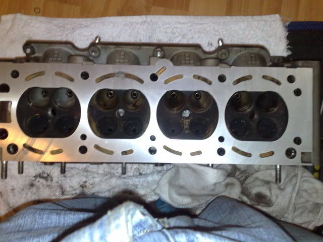

After swearing at the pesky collets, Here is the head now I've removed the valves:
And... here are the valves after a QUICK clean. Note they are kept in order by being pushed through some labelled card.

Blimey, that is a lot removed, did he give you a figure as to how much?
Personally I would of got it skimmed after the full strip and clean.
Re: Project "No Fear" - Cylinder Head Refurb Progress"
« Reply #6 on: 14 May 2008, 11:06:31 »
Reason for not doing this, is because he gets swarf EVERYWHERE(!) so i wanted to strip and clean it after the event!

« Reply #7 on: 14 May 2008, 12:08:48 »
Having done a few on various cars I agree.  Its a pain to remove and leaving the valves in prevents too much crap getting everywhere  :y

Thought you were going to clean it.....the combustion chambers look filthy (note, paint stripper  :y!)
I note some corrosion around one of the water ways.
As for the skim when stripped and cleaned, I always give a further thorough wash down after the skim and full blow through with the air line. My thoughts are that if any swarf etc gets near the valve assemblies/follower bores/valve springs then its easy to get rid off where as you risk scouring these areas when removing the valve springs otherwise.
