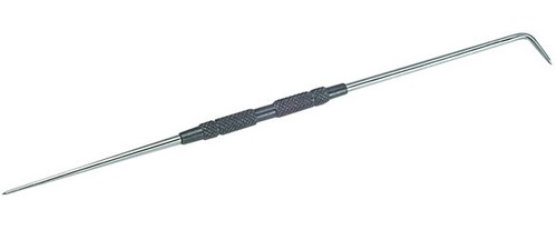

Andies, car is already oiled up and in use but not yet checked if its leaking. Will do this next weekend. I hope it doesnt because I really don't want to do this again. I left the silicone 18 hours to cure and then I disturbed the bolt so it should be ok... but then again it could leak because I disturbed the bolt and the silicone in the process  :-X  I will try Andy Bs suggestion of using a screwdriver to try and turn it. Dont own a scriber, have no idea what one is  ;D  #
Hardened steel 'pencil' for scratching/scribing lines onto metal  :y :y :y
