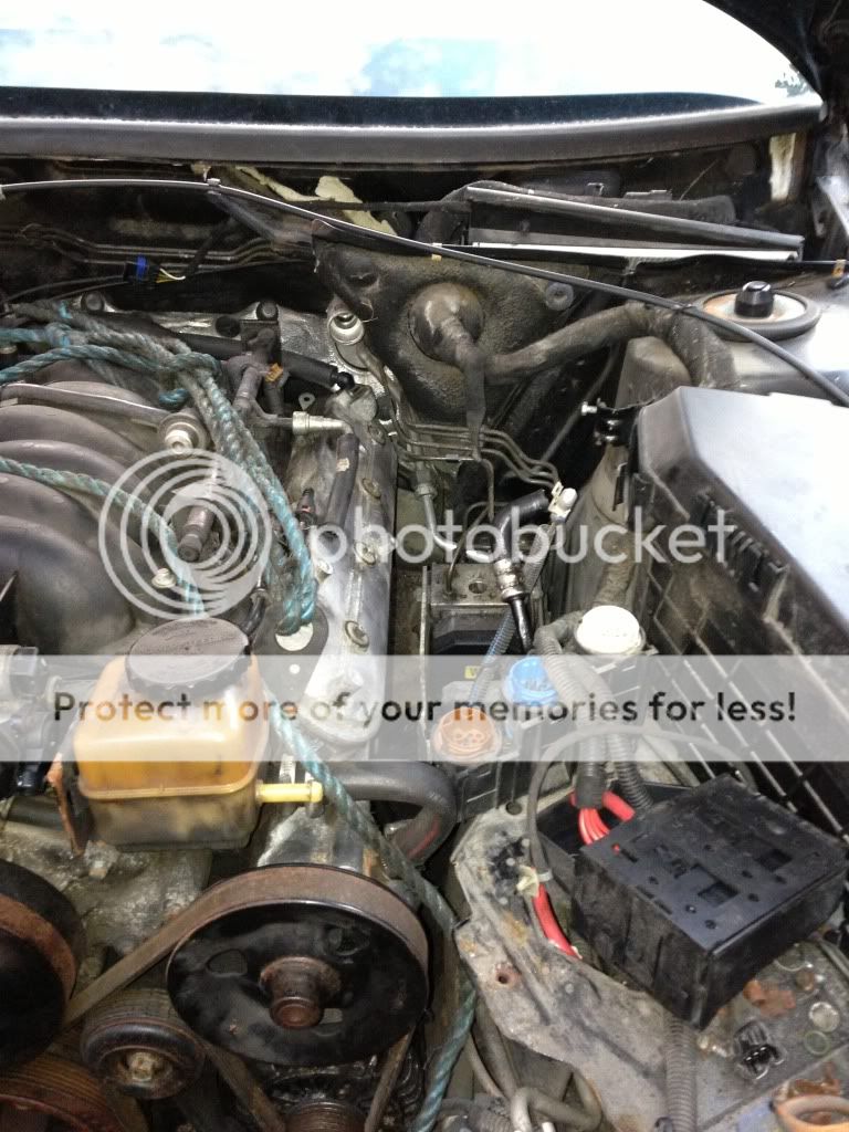

Engine bay drivers side.
Steering box removed. There's no way I'm entertaining this with a steering box, there simply isn't room enough. I know gm managed it with severely compromised headers, but that's not for me.
Al tried to get the box in there just to see how close it would be, there isn't room to slide it down the side, and there's no headers or plugs leads fitted yet.

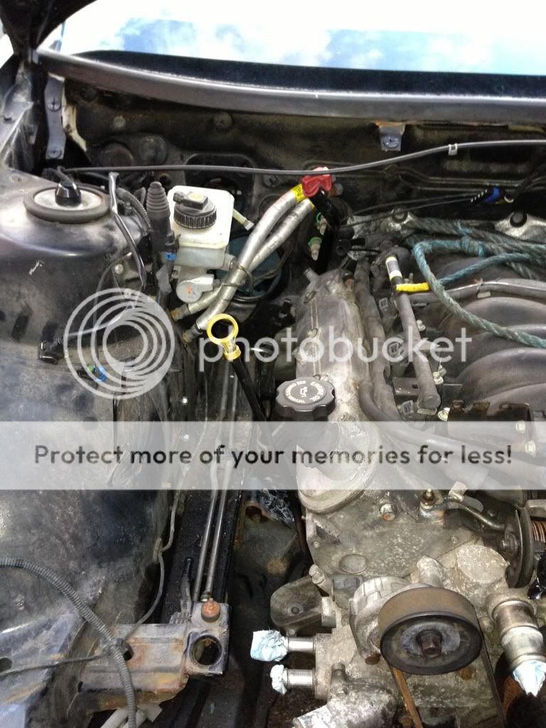

« Reply #8 on: 19 August 2013, 23:33:45 »
Engine bay pas side.
Abs pump will be moved... Somewhere. :-\ ;D
