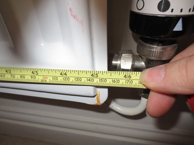

Academic now I know, but why exactly did you have to drain down?
http://www.omegaowners.com/forum/index.php?topic=118874.msg1508281#msg1508281
reply number 9
Bleed valve is still closed, so what is easier, drain one rad with it closed or whole system? Still, as I said, academic now. :y
TRV screws straight into rad. So either the valve has to unscrew (thus disconnecting the feed pipe), or the rad has to unscrew (not practical).

« Reply #87 on: 29 October 2013, 20:31:30 »
I was originally suggesting that you should be able to crack that nut behind the 46" mark, and drain from there, or the other end, with both valves off, thus avoiding a full drain down. The stuck bleed valve just makes drainage, either single rad, or system, marginally more annoying. :y
