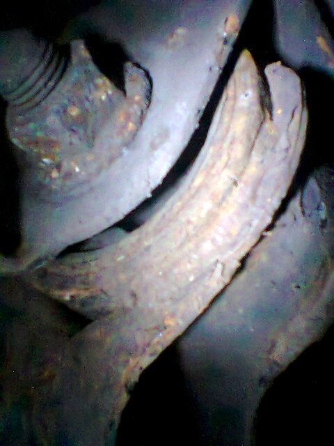

Cheers mate  :y
heres a pic of the fubard bush... not that it makes any diffrerence as you really need to see the play I suppose but thanks for all ya help chris  :y :y :y
RIP Paul Lovejoy
chrisgixer
Re: FFS. Omega hit curb...what damage?
« Reply #51 on: 22 November 2013, 22:50:31 »
Christ, those bolts haven't been off for a while have they! :o suggests the bushes are old and knackered by now anyway. But you want the source of the noise first. Don't want to do the bushes, set it up, then find the springs busted or sumat daft.
I'd get some penetrating lube on their while your diagnosing. Get the ball joint bolt as well, be careful not to spray the brakes of course. :)
