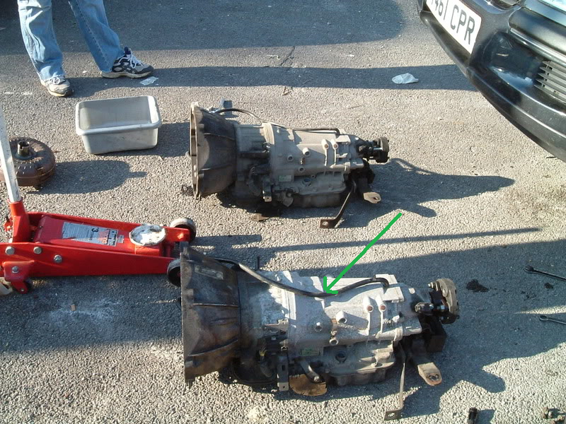

ps does anyone have a pic of the breather pipe coming out of the gearbox..... that way when I get it on the ramps I can fish it out and re-route it correctly :)

this it?

Re: Topping up autobox...
« Reply #12 on: 14 December 2013, 17:59:46 »

cheers albs.... felt a thick pipe like that but couldn't see it. will have to take the scuttle off...and its cold outside  :'(
