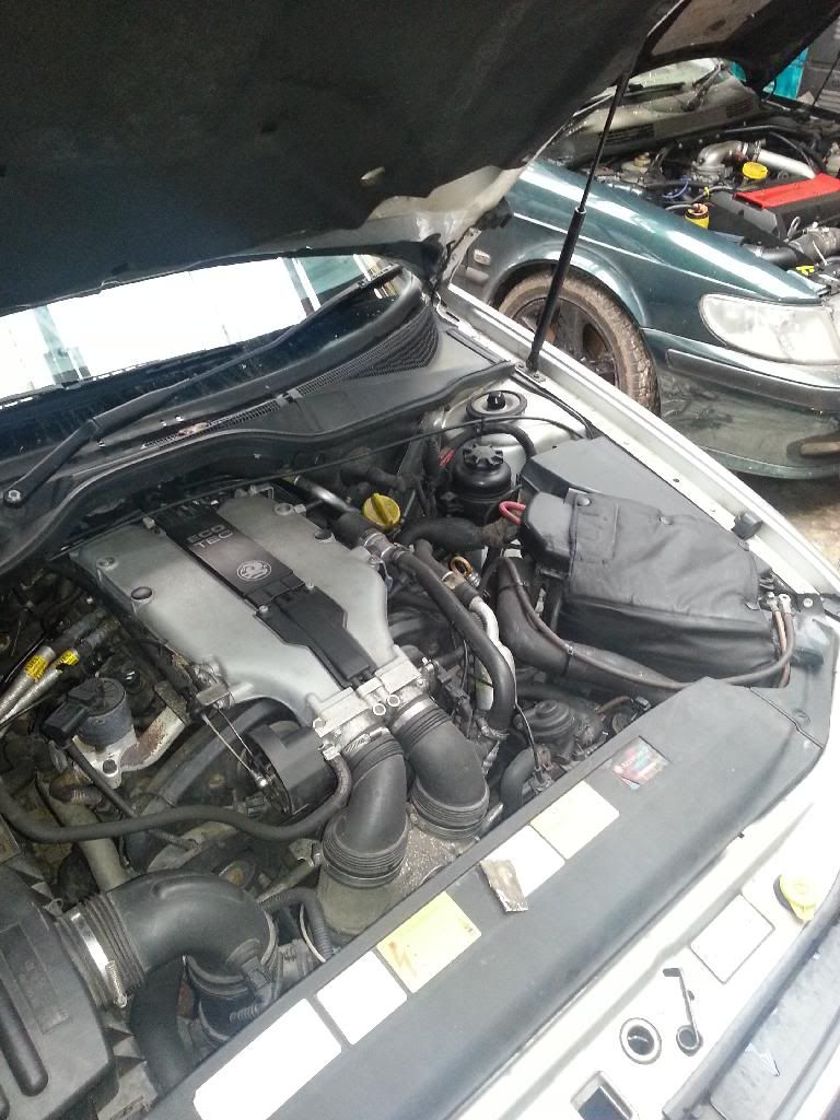

Forgive my stupidity... but it looks like someone's removed the heater pipes and joined them together....???
Not stupid at all,I think your right :y :y

thatchers is getting consumed as we speak might have to upgrade to the scrumpy if I find anything else lol
well.... I found the cause of the heater issue :  >:(

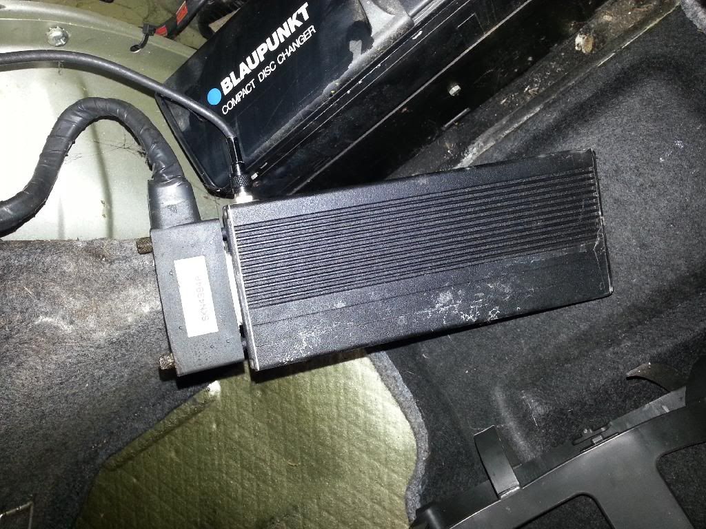

wtf is this I found by the cd changer while looking for leak..?

 Has the car belonged to the constabulary if so might be somthing they left in there or a phone unit :-\

the matrix is indeed bypassed with what appears to be copper pipe

its for a phone, got one in my mv6, still works aswell.  :y

Classic heater matrix bypass when it has failed.
Expect you will find it has a leak possibly from oil contamination,but either way to restore heat inside you are looking at replacing the matrix.
Done my own about this time last year and it is actually not too hard if you adopt " the cut,n,shut method" which I confess to doing.With care you will never notice it has been cut and not too pricey,but the 2 0 rings for the matrix feed pipes are VX only and down right extortinate but essential.
Good luck with it..no of it is in-summountable just the clutch being a tad more hard work.
