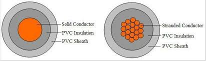

before i go any further can someone explain (cross section) as im a bit confused then i may be more helpfull.
omega is like marmite you know the rest
RobG
  • Posts: 13831
    • 16 plate Mokka. Vivaro
Re: fuse jumper wire
« Reply #31 on: 19 February 2014, 19:33:37 »
Diameter of conductor (copper wire)
darrenfos
  • eastleigh
  • Posts: 282
    • omega elite manual
« Reply #32 on: 19 February 2014, 19:39:28 »
right the copper wire is no more than 1mm thick, including the rubber its prob about 1.5mm, and the whole length of wire is just under a meter
« Reply #33 on: 19 February 2014, 19:39:34 »
thin wires can only carry small currents, thick ones carry more, so the cross section (thickness) of the wiring "may" give an indication of the sort of current it is expected to draw ....
  • Posts: 107668
« Reply #34 on: 19 February 2014, 19:51:19 »
Is it multistrands in each wire, or a single solid piece of copper. If former, is that 1mm for all the strands combined together?
