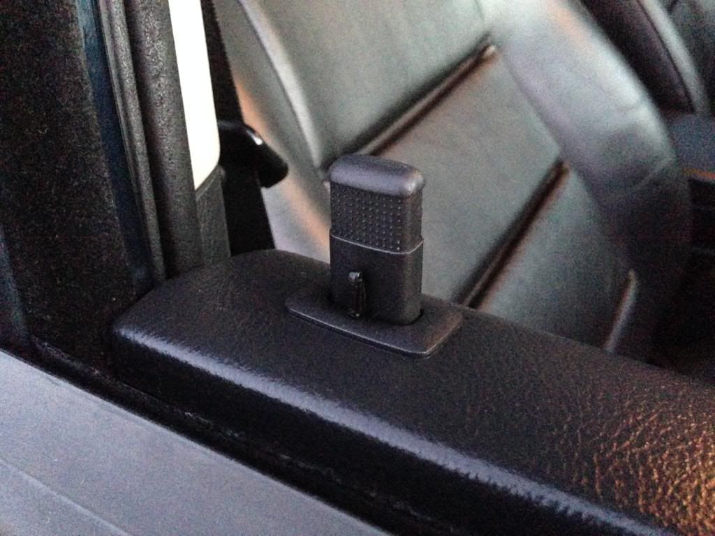

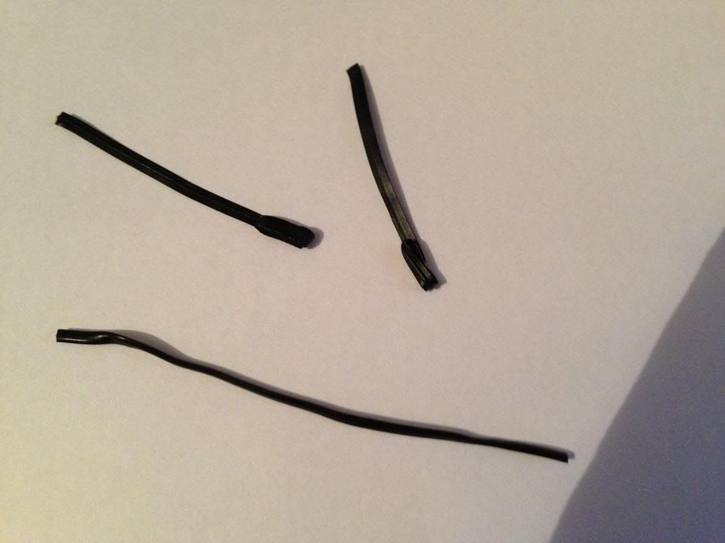

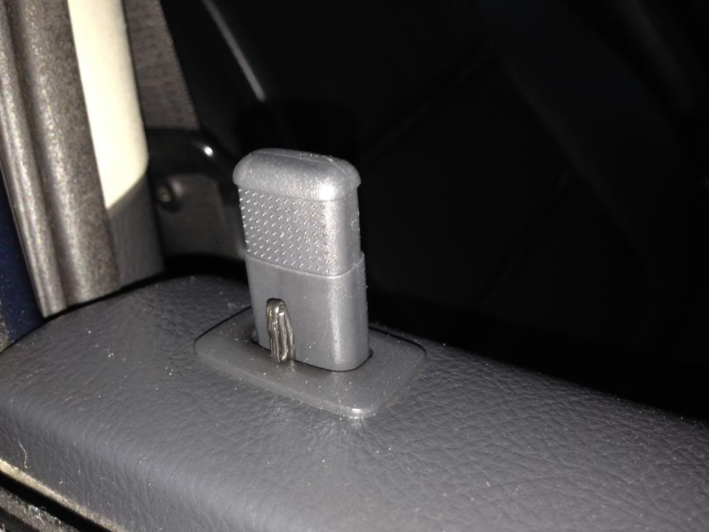

Re: Is there a guide on rattling door pins
« Reply #14 on: 17 June 2014, 22:56:28 »
See how these get on, Tidy enough don't notice them really.
Just a small video showing them working with the central locking http://youtu.be/pUv0jedNxrc
If these don't work i'll explore one of the many options above  :y
