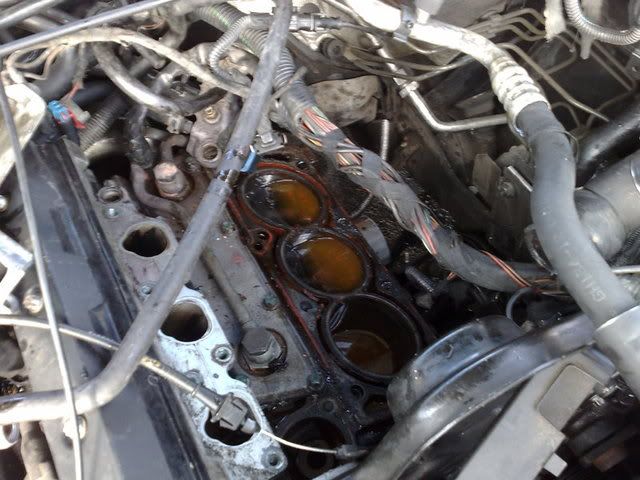

Passenger head coming off:

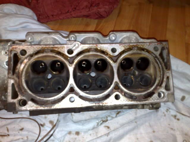

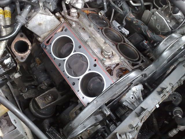

Both heads off, and new HG being offered up to make
sure it's correct. NOTE: The crank was set to 60deg BTDC before head fitting! I had been moving pistons up and down at this stage for cleaning purposes. Also note the corrosion in the water jacket on the 246 bank, where there's been no antifreeze in it.

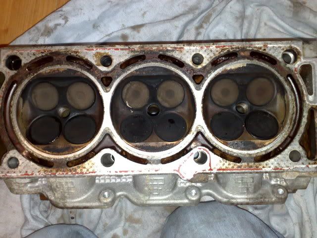

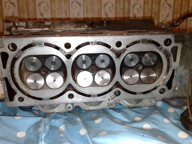

2 4 6 head before rebuild:

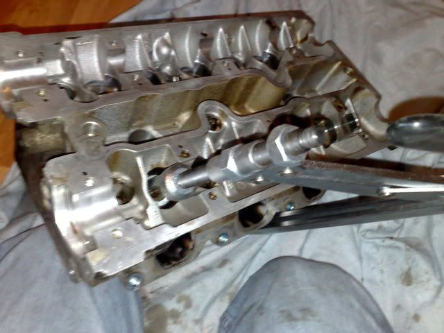

Removing Valves:

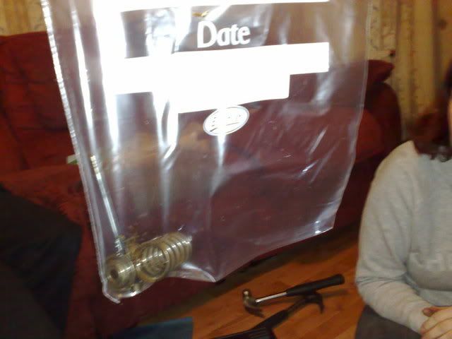

All valve components in bags, to ensure they are fitted in their original locations:

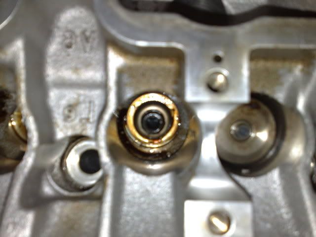

Here is the head with no valves!

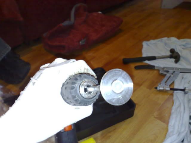

Cleaning Valves:
Removing collet, Valve spring,stem seal and seat washer
All valves cleaned, lapped back in, and fitted with new stem seals:

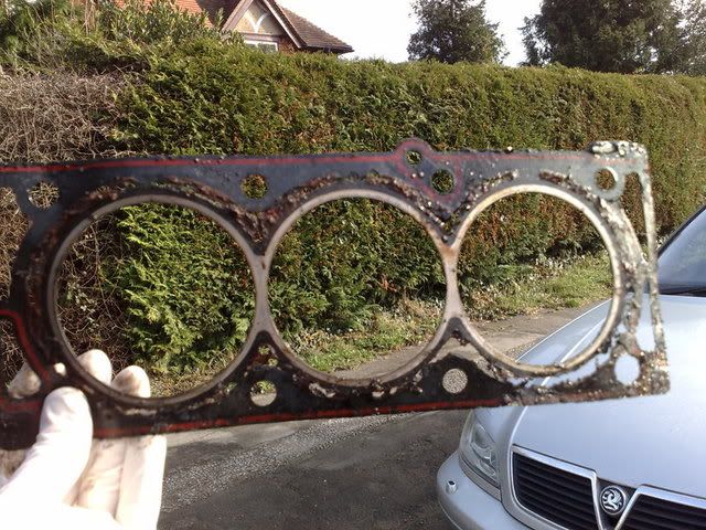

The FUBAR head gasket. (One of). This was caused by running with no antifreeze, I guess:

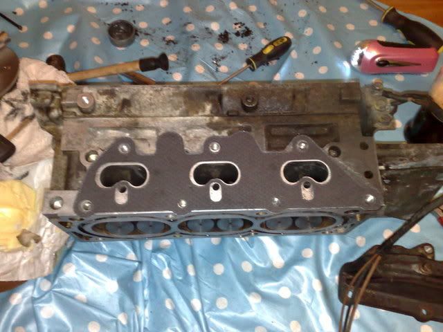

Offering up new exhaust manifold gasket following cleaning of the faces. Note the helicoils in the bottom right two holes..
I obviously used new gaskets for downpipe to manifold too, and new studs/nuts all round.

Tut, tut.....using composite exhaust manifold gaskets!
You can see the head damage around the water jacket on the head face at the dis pack mounting end. Quite a bit of pitting there.
Re: Pictures of my recent engine rebuild...
« Reply #3 on: 30 January 2008, 10:55:36 »
I had MONEY on you picking that up, you sod ;D
End of the day, it's a £300 car, and VX didn't have any in, so I took the risk. Should be OK with new studs and flat surfaces.
That head didn't come off Max's car... it was off my other Elite shed, which was equally poorly maintained.
Think it will be OK with new gaskets and correct coolant?
  • Posts: 34112
« Reply #4 on: 30 January 2008, 10:57:20 »
Manifold gaskets should be good for 3-400 miles or so!
The corrosion should be ok.
In the past we have applied some of the green snot used on the front cam bearings to these areas to help seal them.

Ow, by the way.
You don't need to worry about mixing the valve springs, valve caps, collets and valve bases up. The are all the same.
Its only the valves that need to go back in from whence they came!
