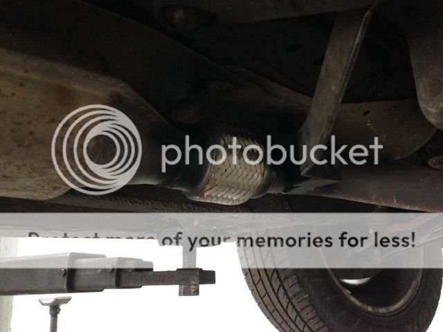

« Reply #30 on: 01 April 2015, 10:53:12 »

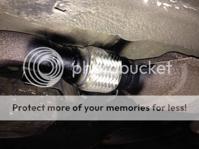

Wow, that was stuffed!
Just made some calls and can get the flexi replaced today for £120 - might have to go for that given the time pressure  :-\
This was just a few days earlier, it can quickly break apart once it's started to go:
  • Posts: 37651
Re: P0420 - Catalyst Efficency Above Threshold - on 2.2
« Reply #31 on: 01 April 2015, 10:54:39 »
What is the breakdown on that?
Part is ~£10...
http://www.ebay.co.uk/itm/2-UNIVERSAL-51MM-EXHAUST-PIPE-FLEXI-FLEX-REPAIR-TUBE-JOIN-2-X-4-650100-/371144483891?pt=LH_DefaultDomain_3&hash=item5669ef6433
Took all of master around 30mins maybe to change? Including a tea break!
Also, any place that does the work, ensure it's put together right afterwards, otherwise it won't line up for the exhaust bolts.  :y

£120 to supply part, remove, weld new part in and refit. I offered to bring just the CATs but they wanted the car to ensure correct alignment  :y
I would rather do it myself and save but I need to use the car to go to Doncaster and back Monday and its a bank holiday Friday.
I just hope I don't find out the CAT is stuffed after all this!

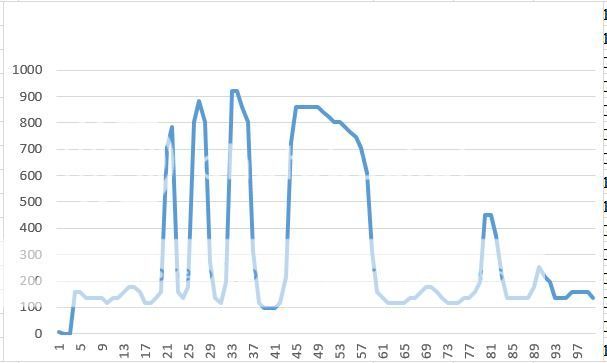

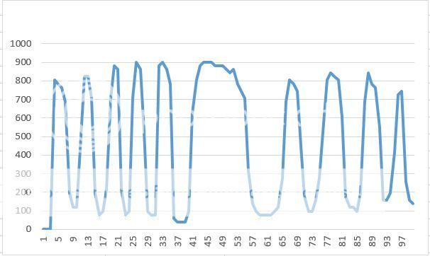

O2 Sensor 1 (pre CAT:
O2 Sensor 2 (post CAT):
Should sensor 2 be cycling like that? Or static?
Many thanks
Steve

CAT looks stuffed to me :(
Get a good 2nd hand one.
For Monday, just drive it with the EML on, if time is against you. The cat is stuffed anyway.

It should be a straight line? Lean?
