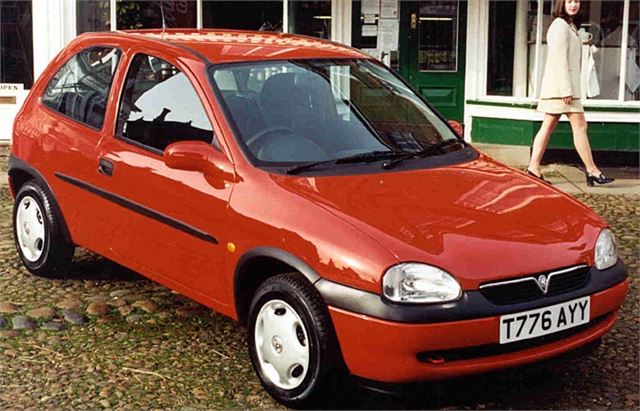

« Reply #11 on: 30 April 2015, 09:51:33 »
UPDATE : All parts are available from Germany, so typically 5-7 days. The metal washers and bushes come in packs of 5.
I'm off up the scrappy at lunchtime to see what I can find. Wish I knew what a Corsa B or Vectra A was.
