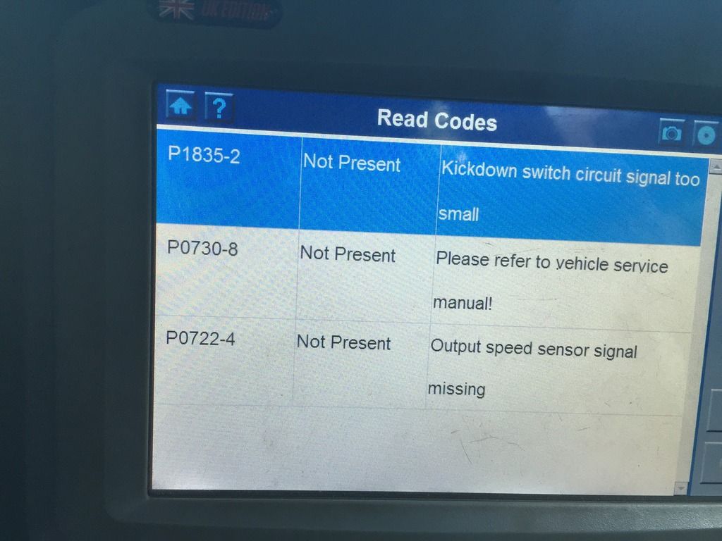

Managed to code read the car and it came up with these faults...

PO722 OSS is the only thing i have not tried replacing or cleaning , cleaning first as £247.84 is a bit pricey for a new one on mine  ::)
