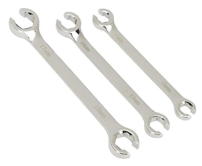

« Reply #16 on: 03 August 2015, 19:26:08 »
Mine was a serious question... Can't for the life of me remember what they're called, but essentially a six face ring spanner with an open face smaller than the side so that all six points drive the hex on the union/nipple :-\
Metrinch?
flare wrench?
Trust webby to get all proper n technically  :D well dun bear  :y

The Bear wins... ....
you don't need them for bleed nipples, they're obviously for unions where you need to go round the pipe  ::)
Re: Front Brake Bleed Nipple
« Reply #22 on: 03 August 2015, 21:08:59 »
True enough, but they purchase better than either a traditional or ring spanner...
They might be better than a normal open ended spanner, but are nowhere near as good as a ring spanner.
I have some, but rarely bother with them as I find that seized brake fittings normally need new pipes anyway.
What you're thinking of are flank drive spanners which grip on the flats. I think that flank drive is Snap On's brand, but most good brands have something similar.
Flare spanner?
And utterly useless on seized nipples. Been there, done it, got DTM to pick up all the pieces afterwards ;D

« Reply #25 on: 04 August 2015, 14:35:08 »
Must read page 2 before replying ;D
But still not much cop on a seized one, even with molegrips either side to reduce any spread.
