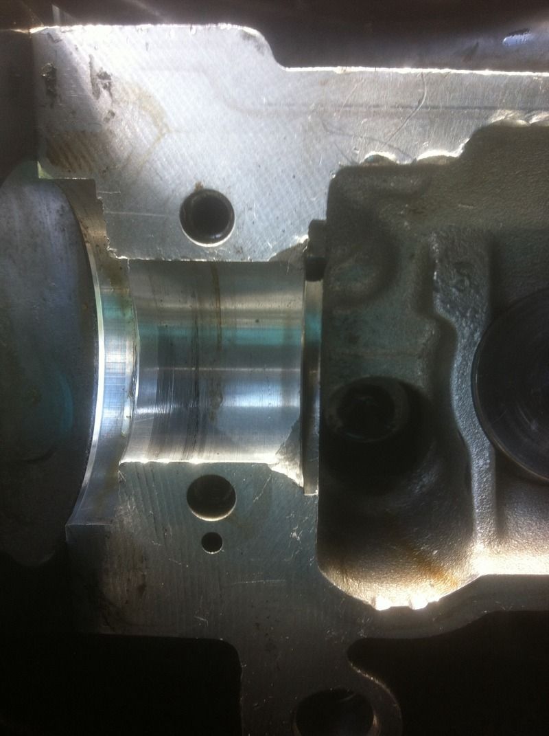

I did take a picture of that rough edge, I will upload it v soon :y

« Reply #43 on: 28 September 2015, 20:02:00 »
Signs of 'pick up' on the bearing face ? due to lack of oil?  :-\
The random beating with a blunt object is puzzling :-\
Re: V6 Nasty Engine Noise
« Reply #44 on: 28 September 2015, 20:12:15 »
Indeed. That has always been there in my ownership even when the heads were on my 3.0
It does look as if something has broken off where the very front of the inlet camshaft sits though
