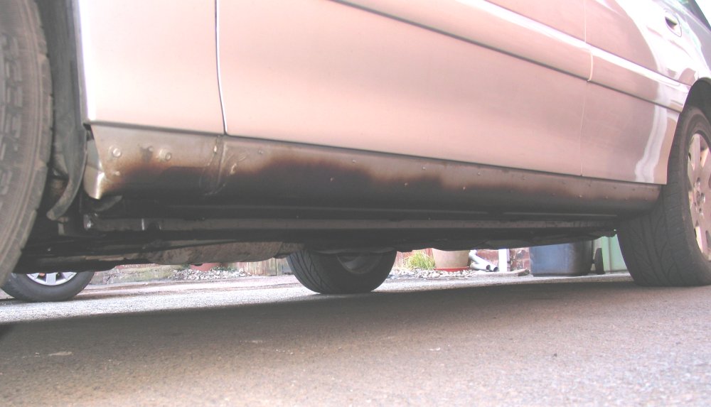

Sill is a piece of piss... one torx screw under the front corner and seven or so pop caps along the bottom edge... Then, with the wheel on full left lock for nearside (opposite for offside), simply tap the sill cover forward an inch or so and it simply falls off :y
What you find underneath it once removed is a whole different conversation ;D
It will look brand new  :y cheers for the howto Al  :y
