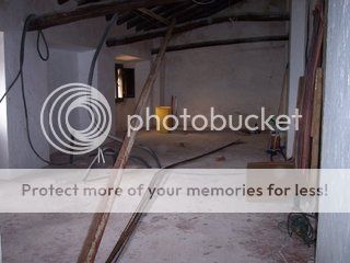

Photo, good idea.
Ignore all the 40 mm grey pipes and the two 15mm white water feed pipes.
Toilet grey waste is the 11cm one in the hole in the floor. Next to that is a floor tile resting on a black object to represent new finished floor level.
Wall behind toilet is represented by the green box at 21 cm ( that would work with current waste pipe location) brown cardboard represents where we would like to build the wall.
That photo just shows the whole area
