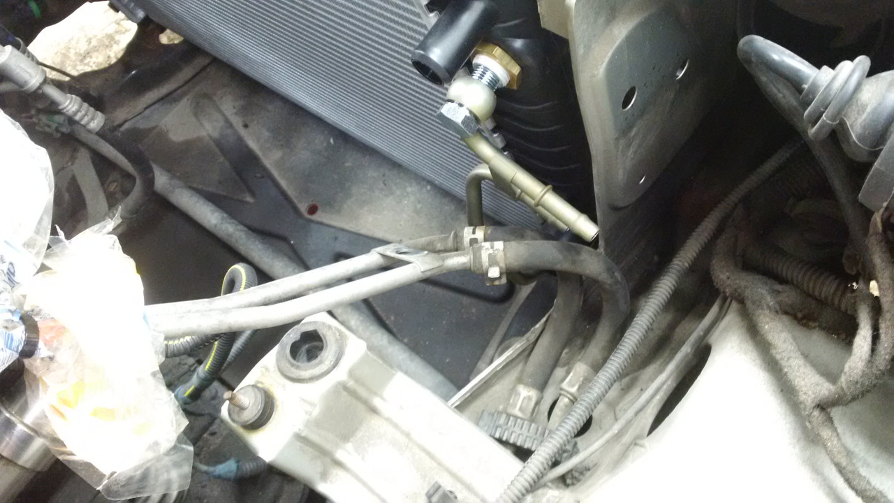

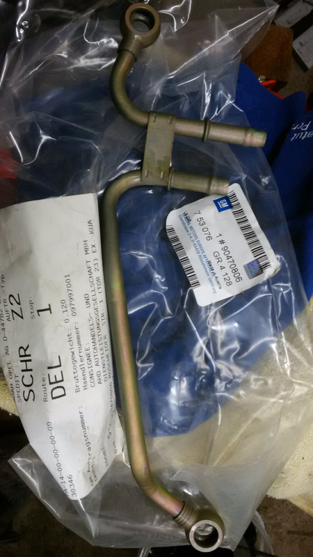

Thanks Enceladus, some pictures, too. Original Rubber hoses can be used if I can separate them from the aluminium pipes.

My response concerned your query about "... strange sealing, combined copper washer and rubber O-ring ..". This sounds more like a Dowty washer rather than an O-ring. A Dowty has a seal bonded into the washer, so it's a one piece item, no separate rubber piece.
Your new pipe GM part #90470806 has a banjo fitting at each end. These accept hollow banjo bolts. A seal is usually required on either side and EPC says these are copper washers M14 x 18mm x 1.5mm. Item 10 on the drawing you posted earlier and is GM part # 11016282. Are these the strange seals you mean? The M14 copper washers are/were widely used as oil pan sump plugs and on the filler plug on Omega autoboxes. So you should be able to get them at any auto factors.
Don't reuse them, at least not on this job. Renew.
Your second photo doesn't seem to show any such copper sealing washers under the head of the banjo. Or one on the other side. What's the white ring? Is that a nylon insert in the brass radiator fitting? Or maybe some PTFE tape? Or is it some sort of seal that's specific to the make of radiator?
Some heat from a hair dryer might help free the hoses from the pipes.
« Last Edit: 18 February 2020, 14:06:15 by Enceladus »

Thanks for comments, with Banjo I bought 14/18*1.5 four pc Aluminium seals, found somewhere that Al is ok, the strange ones were from those two temperature sensors which are screwed to radiator plastic "tanks" found them, too, all ok.

Thanks again Enceladus, now better time to explain...
The second photo you refer was just from the preassembly to check whether extra piping work needed, below completed with aluminium seals. The "white rings" are made of brass. They are some kind of reducing collars for the part 90470806. They were originally there, perhaps white material is some kind of "Loctite"? Nissens 63073A.
