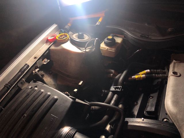

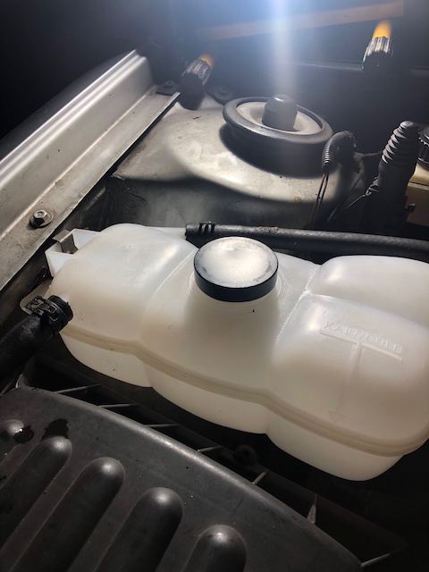

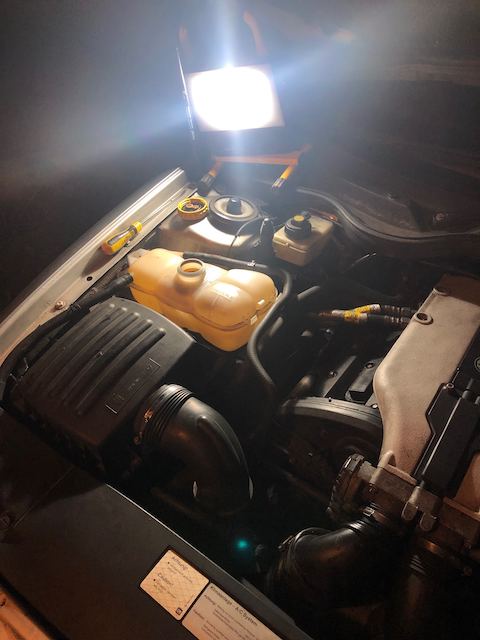

Did you order a new Header tank already, Tunnie?
  • Posts: 37651
Re: Proper Motor
« Reply #7 on: 19 September 2019, 12:54:50 »
Yes and I fitted it last night, at around 10PM due to other commitments.  :(
Fitted, filled it up with cap off. Ran it up to engine temp and made sure stat opened. (top right rad pipe hot) - Burped the system to clear any air leaks, it dropped a bit when stat opened.
Topped it up again this morning before work, however on arriving at work, the level had dropped again.  :( - I hope it's just settling, as I did drain coolant via the rad tap when emptying the system.

  • Posts: 37651
Re: Proper Motor
« Reply #10 on: 20 September 2019, 21:21:03 »
Draining it to change coolant bottle. That's keen :)
Though changing the coolant can never bee too regular, for reasons stated in the past :)
I had 10L of stuff in garage, so thought why not, besides it was easier/cleaner.
That said, the problem is worse.  :(
I think the temp new cap (eBay junk) did not form best seal, hence seeing coolant there. New bottle and cap (Vauxhall sourced) it holds pressure better. But I'm seeing an increase in coolant consumption, I'm also seeing a return of miss-fire on start up which is much worse that before and takes a while to clear before it runs well.
