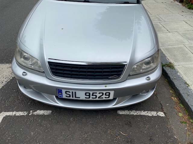

I already done the headlights last week, did not come up as good as what I expected, looked good at the time, but think I might need to do them again, masked them, 4 stage sand and polish etc., final coating on and all that.

Done last Sunday pic below...….

Nice one.  :y

Results partly depend on what you are starting with ;)
Also, I don't think that 40 grit is wet and dry :D

Use the four small sanding pads that came with the turtle was kit, then today found the Megiuars lens cleaning kit, hiding in the boot all the time, thought I had thrown it, hence why bought another one, need to go to specsavers!!!
