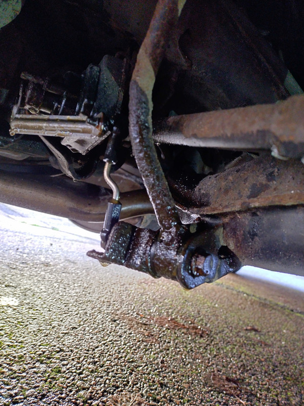

Well now I am confused................maybe not unusual now given my increasing age!!......but yes I am!
I have removed all four wheels and inspected the area surrounding the suspension struts and arms.  But all I found was as in the following picture (after I had soaked the device with WD40), which was on the suspension arm of the rear offside.  It is nothing like the device I used to find, and once replaced, on previous Omega's.
The arms and joints of this device were all intact and are an improvement on the ones previously seen, although it is still so exposed.
So, what does this change with a 2003 3.2 miggy mean?  What am I missing. Is this one device the issue that must be resolved, or is there another device hidden elsewhere please?

99% of the time it's the front sensor on the wishbone, no the rear one pictured
Thanks, but I could not find one on the front or rear wishbones. :o :o
I do not know what to do now.  Has anyone got a picture of one on a 2003 3.2 please? ??? ???

The headlight sensor is on the front, near-side wishbone, close to the rear bush. It looks like the one in your pic, but with a shorter lever arm. If the droplink between the arm and the wishbone is missing, it's much harder to see. And that would definitely create the warning you have.

Yes, YES!!!  Thanks again Nick!! :y :y
Found it, but not in the place it was on previous Omega's.  It was set well back behind the suspensions strut and partially mounted on the chassis with the link on the wishbone.  There it was, the bottom of the lever floating in the air, separated from the wishbone fixing.
This is how it is now, although I have since removed the ends of the cable ties, after taking the advice of DG and Dave, with cable ties that I have always a stock of due to my electrical work:
Should work.  It certainly has got rid of the advisory message! :D :D :y :y

That first picture is the rear suspension level sensor/ecu :y
Thanks DG, that explains a lot.  Never noticed that sensor before. :-[ :D ;)

Reason the arm had popped out is obvious - the ball joint is bone dry - needed some grease on it, because it is dry it will have worn the joint so will always need tie wraps to keep it on.
