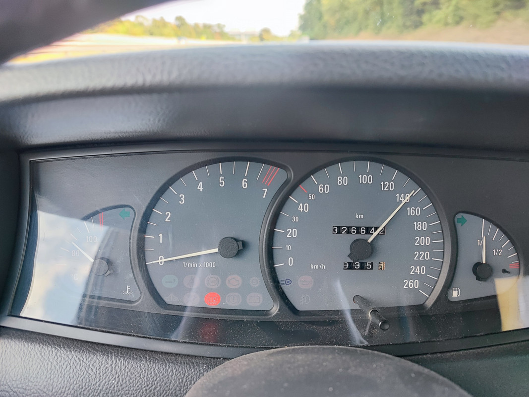

Hi guys, my Omega had a classic ABS unit fault (ABS/TC light on and no speedo) so I replaced it with my previous known good one from 2.5V6, which was laying in attic for three years. This unit was working fine for almost seven years in my 2.5, but now I'm getting  TC light on.
Both unit have the sam part numbers on and ABS pump is also the same - marked as DX.
Where did I f....up? :(

Oh...and I just noticed....no RPM

danzigfan
  • Jesenice, Slovenia
  • Posts: 1499
    • Omega 2.5V6, 3.0V6
Re: TC light on
« Reply #12 on: 20 August 2024, 18:58:50 »
Speedo is fine, cruise control works, ABS is fine...And doing it all again just to see if it works fine with old ABS unit, that had occasionally problems with no speedo, abs + tc on, just the thoight of that makes me ill...Bloody unit is cramped so deep inside, my swear jar is full
