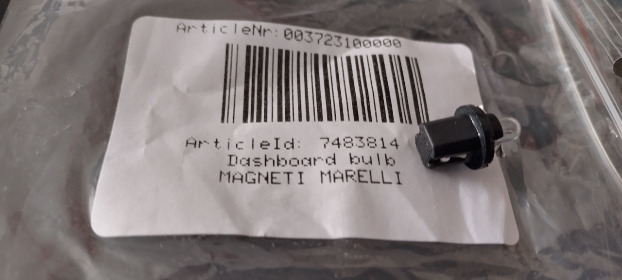

Just delivered, only 3 days after ordering from Autodoc in the EU, the 6 dashboard light bulbs:
Great service yet again 8) 8) 8)  Will see if they fit when the weather lets me get out there to do my car!! ;D ;D ;D ;)
