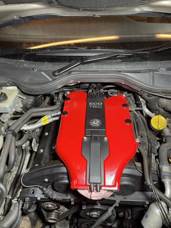

« Reply #148 on: 23 March 2025, 14:11:02 »
Thanks for your kind words Sir T!
Just a bit more before setting off. A little bling never hurt anyone...
