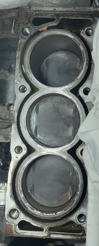

Progress! 1-3-5 head is off.
Slight shiny patches on the inlet valves. Matching shiny on the piston crowns. All others are very dark.
Bores are very, very smooth.
Any damage opinions so far ?
2-4-6 next.
  • Posts: 30607
Re: Massive Clattering Noise
« Reply #184 on: 30 April 2025, 16:37:39 »
If the valves are still true, then reseat them, if not replace them.
Pistons will take much worse to be actually damaged  :y

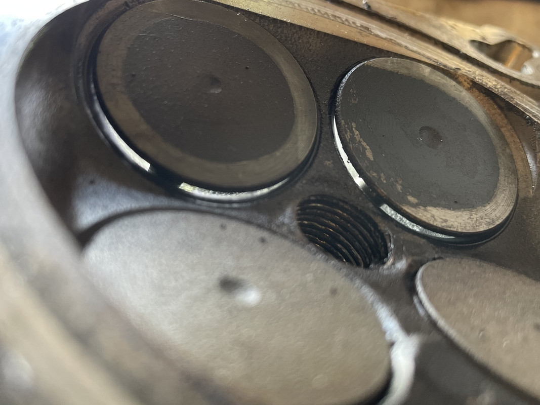

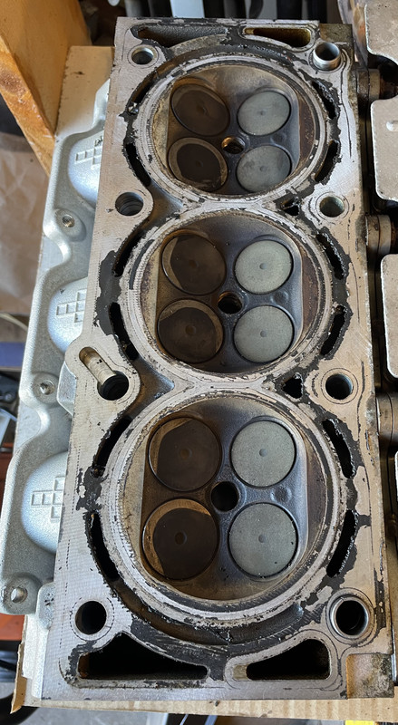

A quick update. Second head off now, and cyl 6 is clearly showing daylight through the valve seat. So they’re all coming out for checking over.

  • Posts: 30607
« Reply #186 on: 10 May 2025, 14:32:23 »
That's your smoking gun alright :o
