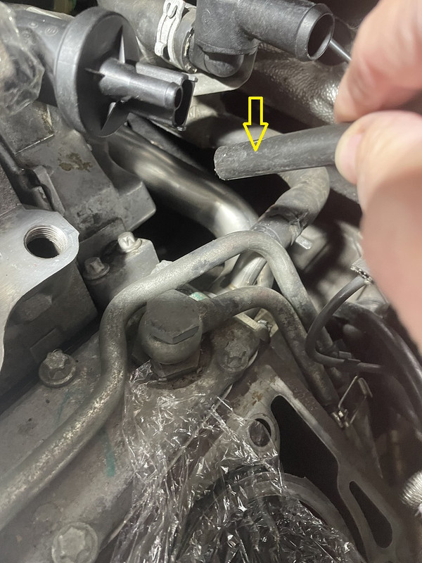

Can anyone identify this pipe?
« on: 03 June 2025, 13:20:23 »
It's hard plastic, not rubber, looks like it's never had a connector on it. It just hangs down behind the 1-3-5 head.
It's looped over the back of the engine, goes downwards on the nearside, then seems to go along the side of the transmission also on the nearside.
Is it just a vent of some sort? Or should I be trying to find where it fits?
I know it's nothing to do with that valve that's also in the pic.

Auto transmission breather pipe most likely - supposed to vent to atmosphere :y

Thanks for that James. One less thing to worry about!

That solenoid valve to the left... Be mindful of the following.
It's the purge valve from the charcoal canister to the plenum. It uses the same type of connector as the ECU temperature sensor just below it.
These are not interchangeable as the purge valve is 12v but the sensor is 5v and will fry in pretty short order (pun intended).

Yes I just noticed that as your post arrived.
Hoping that each one will reach its allotted socket without stressing the cables.
Looks like the wire colours are the same in both as well.
Hang on. Blue & grey in both, but the shorter one might have a black stripe on both wires.
I can park that for now - getting ready to replace head #2 tomorrow.
